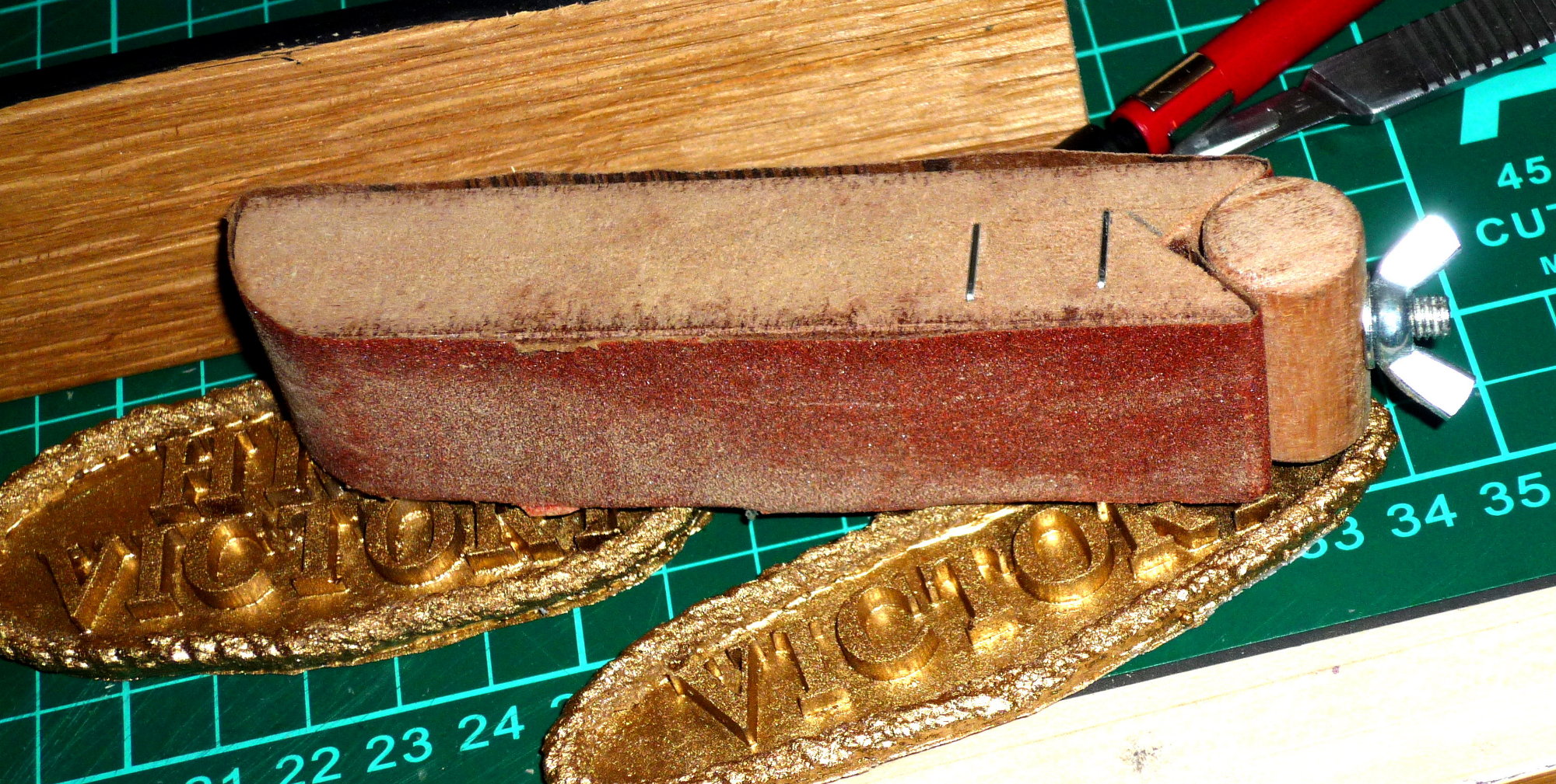

make a block out of MDF to shape required. 1" x 1" x 4". Cut a V in one end and epoxy a 6mm bolt into hole in V, head first..
Drill a 6.5 hole through a piece of dowel thread onto bolt and tighten with a wing nut. insert sandpaper from one side of V around block to other side of V. tighten windnut. Sanding block !!!
Sanding block.JPG (687kb) downloaded 115 time(s).

Hi Grizzly
Your sanding block design is brilliant, well done

Not my design, I saw it on the net but as you know things are xpensive in SA so I make a lot of my own equipement.
