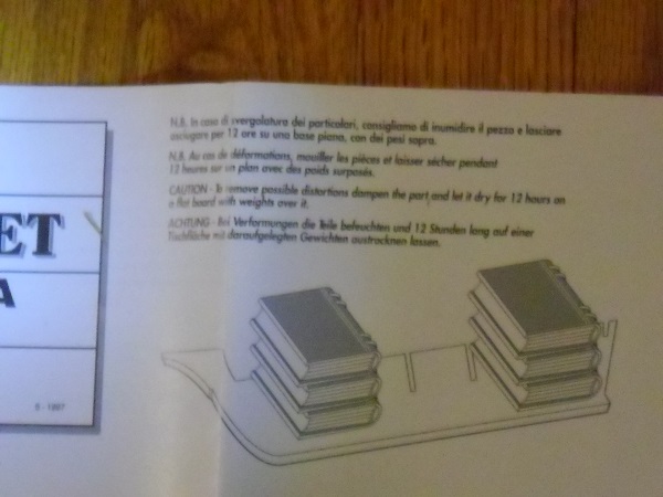

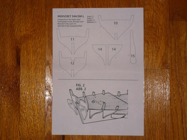

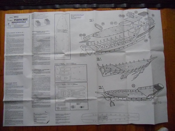

It came with two sides of a large sheet with drawings and written instructions (in 4 languages). The instructions aren't all that detailed, but they insist that they are sufficient to make a good model.
There was a small section of the instruction sheet (the fourth picture) that tells you to cut out pieces of the paper, glue then on to some of the wooden parts with 'vinyl glue' and, when dry, paint with 'acrylic colours or matt smalts'. I don't know what that stuff is, and I hope someone here has some experience with how to best deal with that stuff.

All of the written instructions are about 3 paragraphs on the front of that big sheet. The first thing it says (which I reproduced in the first picture) is to wet the keel and put heavy stuff on it for 12 hours to make it flat as can be. So I ran some cold water over it at the kitchen sink, dried it with a towel, and put it on the table with a stack of books on top. (Before I did this, I put it on the table, and when I pressed on one side, the other lifted about a millimeter. I'm not sure that's enough to make a difference, but I figured I might as well follow the instruction.)

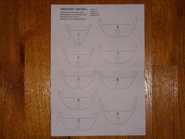

The bulkheads weren't labeled on the parts themselves, and many of them looked almost exactly the same shape, so I was concerned that I wouldn't be able to distinguish them. But, leafing through the papers in the box, I found a sheet of paper with full size drawings of each part, so, with some measuring, I labeled in pencil each of the bulkheads.

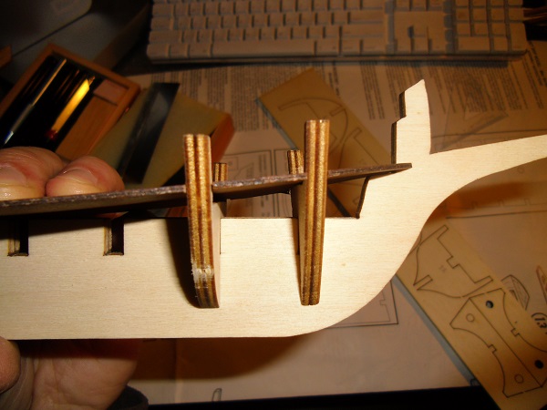

So, the written instructions would have me glue the bulkheads onto the keel as my first step. But, as I look at the pictures on the instructions sheet, there's a picture of the deck with notches cut out. And I'm thinking, "if I cut these notches out exactly as on the plan, I should be fine." But I decided to cut out the deck notches before gluing on the bulkheads, and it turns out that the notches on the plan are way too small to accept the bulkheads. So I decided to dry fit the bulkheads first, and cut out the deck notches to make sure everything fits before I glue it. (additionally, it turns out it's much easier to fit the deck to the bulkheads if they're not attached to the keel.)
So the first picture if of the 'deck jig' as on the plan sheet, and the second shows how the notches I ended making weren't all that close to the drawing. But that's what it took to make them accept the bulkheads. I have pictures of the first two bulkheads individually, with views from above and below the deck, and then a picture of the two bulkheads and deck dry-fitted onto the keel.
You can see that the deck slopes down pretty severely from the bow to the first bulkhead. I'm not sure this is ok, but I'll add some more bulkheads and see how it looks.

Incidentally, a question to the more experienced ship modelers here: from what I've seen, the bulkheads usually are meant to fit into the slot such that the top of the bulkhead is flush with the top of the keel. In this kit, the top of the bulkhead extends significantly above the top of the keel. Is that ok? or am I doing something wrong?
(I also note that the bottoms of the bulkheads don't extend to the bottom of the keel; in this model, they don't add a separate piece for the sternpost or bow, or for along the bottom (I think it's called the true keel or false keel?). The plywood center piece gets planked such that part of it sticks out in front, in back, and along the bottom. From what I've seen, that is not the way it is commonly done these days...)
#12 Posted : 02 February 2017 22:21:36
BigGrin The bulkheads are the same as the Vasa I am building that they don't go to the bottom of the keel so as long as the slots meet at the keel and the bulkheads it should be fine Cool If you have a one to one plan check with that. Hope this helps rgd Martyn

thanks Martyn, yes it does help just to get some feedback. I did look at the pictures, and they show the bulkheads sticking up above the keel too, so I think I'm on the right track. The deck certainly isn't going to be flat; there's a nice downward slope from the bow. I think I'll have to really clamp it tight when I glue it in to keep it in contact with all of the bulkheads (but I'll worry about that when I finish cutting out all of those slots...)
#15 Posted : 02 February 2017 22:35:39
Hi Richie, from what I can see I would say things are looking fine. It was common for ships to have decks that sloped from the bow and stern towards the centre so is not unusual. Cool Cool .. Will be following...

I understand your concern about the sharp rake of the deck from the bow, but as long as you've placed the correct frames in the correct slots in the keel (and I see no reason to think that you haven't), then the angle would appear to be correct (although from looking at the drawings you've provided, the incline doesn't appear to be that pronounced).
I'm sure that once all the other frames are in place and you've ensured that they are seated correctly in the keel and the deck dry fitted again, the incline may look less severe than when taken out of context with the rest of the hull.
