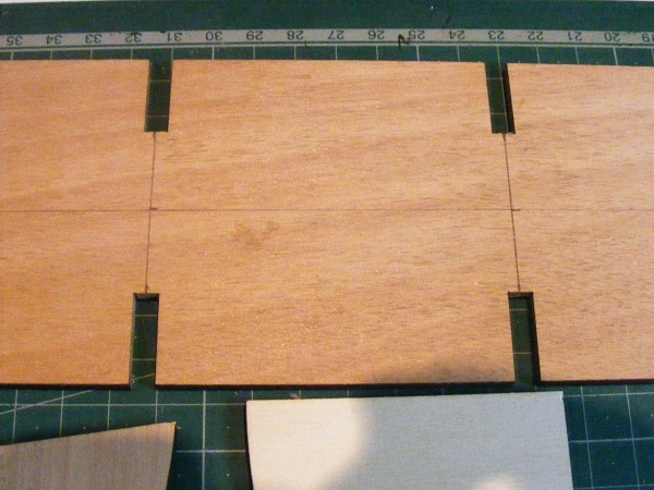

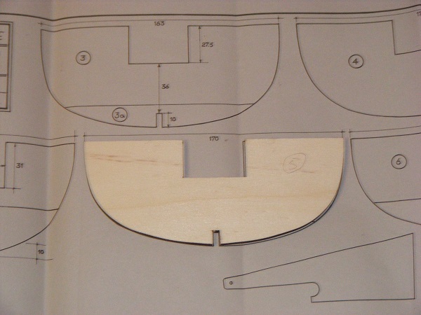

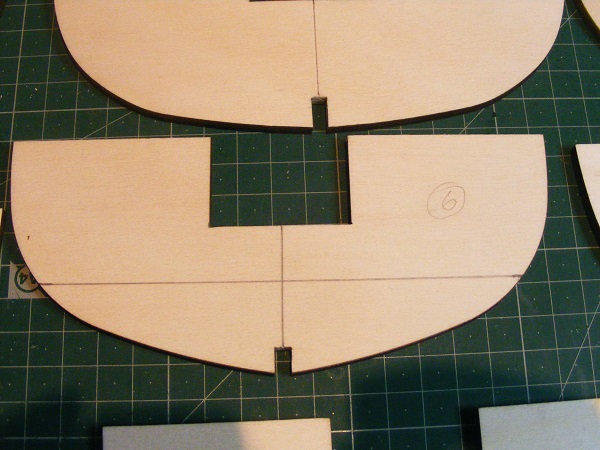

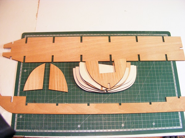

The start of the build was to remove the keel, frame support and all the frames from the frets, clean the slots of all the burnt ash. None of the frames etc are numbered so next thing was to identify each frame and number them accordingly from the 1 to 1 plans and at the same time transfer key marking onto the parts.... Cool Cool

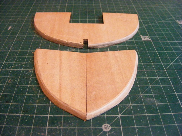

Next it was onto initial fairing. The instructions call for only the forward two frames to be faired but on test assembly it became apparent a couple of other frames needed slight fairing too, especially if I wanted the planks to sit correctly and follow the shape as closely as possible.Cool Cool ..

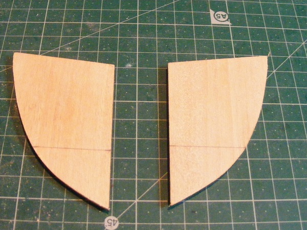

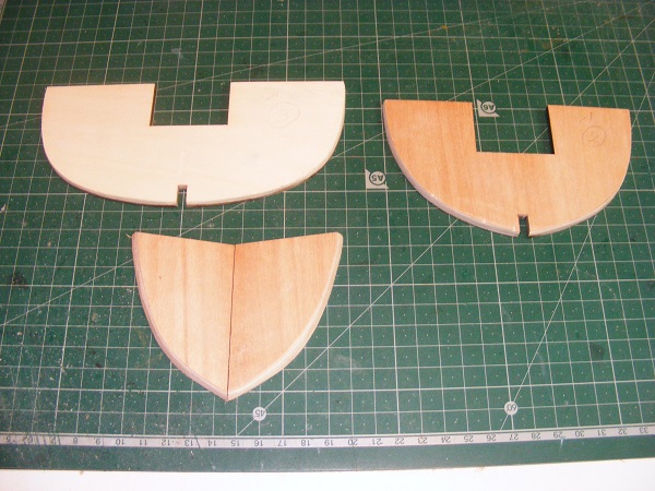

Moving on with the build. Next item was to take the two bow formers and where the line was drawn (from the plans), I sawed almost all the way through. The bottom part of the former is the only part that is glued to the keel, the top part will be removed when the planking is completed. This also means I cannot glue the planks to this former until I get below the cut line, its a former only. The only part of the planks that can be glued to the keel is the very end, just the thickness of the plank. This will no doubt add to the challenge of this build....Blink Blink Blink

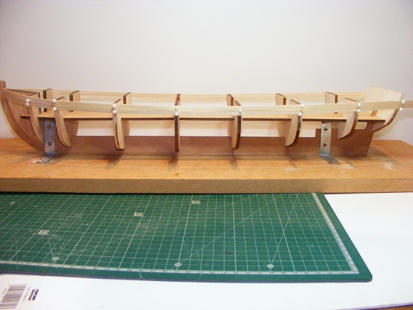

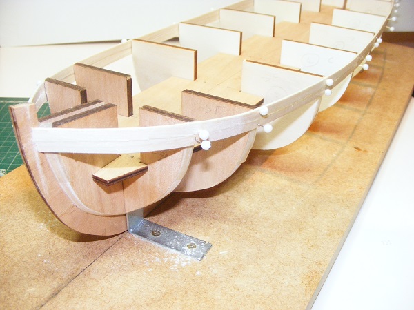

Now that I was happy with the test fit it was time to start putting things together... I decided to apply a little PVA to the lower slots on the frames and attach to the keel, this I did to help ensure the frames don't move during the planking phase... With the removal of the frame support I can access the lower part of the frames and apply a little hot water with a brush so the frames can be removed, at least that's the plan... Cool Cool .. Cool Cool I then gave some thought as to whether to use a build jig or not. Experience in building ships has shown me how easy it is to apply twists or warps to the keel during the early stages of planking so with that in mind into a build jig it went.....Cool Cool

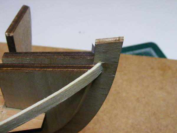

With everything secure my attention turned to how best to start planking bearing in mind glue is only applied to the transom and the tip of the planks at the bow. Thought about using double sided tape but didn't think it would hold the planks securely enough. Still applied double sided tape to the frame edges, it will help hold the planks but more importantly it will prevent accidental gluing of the planks to the frames...Cool Cool Attention turned to how to keep the planks in position at the bow, at least until the glue dried and ended up making up two small tools from spare planking, gluing strips together and profiled the ends to match the bow supports. A trusty G clamp added the final touch and I now think I have that problem resolved...Cool Cool

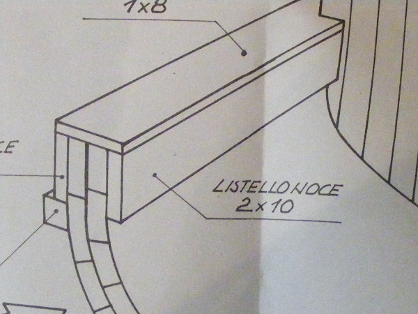

Studied the plans for a while and noticed the capping almost covers the first two planking rows. That means I can quite happily pin the first two rows to the frames which will give me a good start and something solid to work from plus the pin holes will not be seen from inside or out. First plank has now been glued and pinned and this will now be left overnight to see if everything holds especially when the G clamp is removed. If successful then will apply the first plank to the other side and move on from there.....Cool Cool

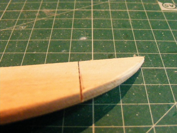

So we progress a little further. Pleased to say it would appear the plan is working, the planks are being held fast at the bow. Having crossed the first hurdle I then moved onto applying the first two rows of planks. This involved getting the profile correct for each plank and this I did with the use of steam from a kettle, took a while but think it was worth it. These planks are pinned to the frames and glued together by their edges ensuring no glue appeared on the inside of the hull. The pins will remain in place and only removed when the hull has it's first covering...Cool Cool Cool This is how she will sit overnight to let the glue cure then I'll apply the next row....Cool Cool
