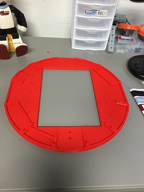

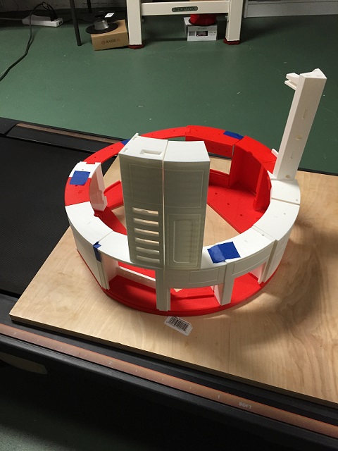

Here is a my build diary for my full size R2 D2 build.The main part of the build will be 3d printed.I will buy an aluminum dome and motors and electronics to make him fully functional.
This will be a Looong project as there are over 200 pieces to print.
here is my progress so far.
The base of the body is made up of 6 printed parts.total print time so far 30 hours.

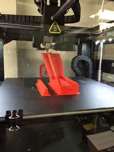

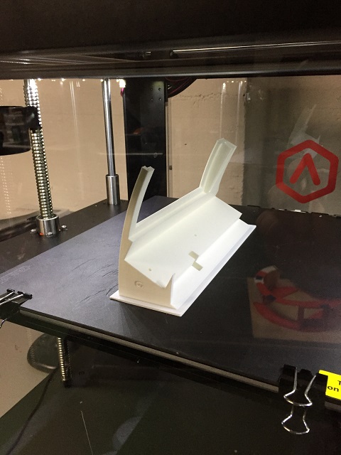

I am using a Raise 3d printer to print the parts.This machine has a very large print bed which is perfect for the large pieces needed for a full size R2.
Here it is printing one of the pieces that sits on top of the base. This piece was about a 7 hour print.

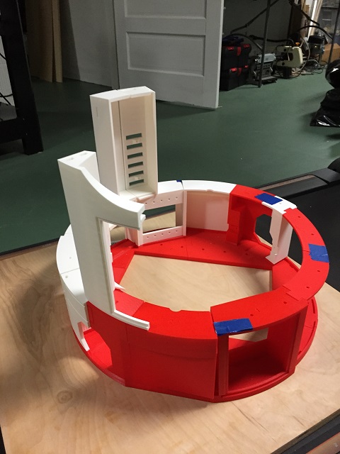

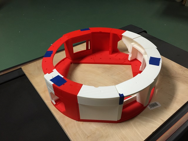

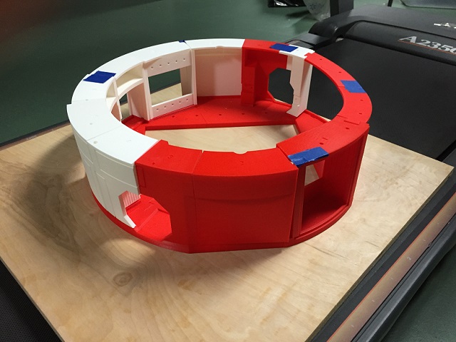

So I have now printed the base and the first on 3 rings that make up the main body or R2.I has taken about 100 hours of printing to get to this point.
The first ring is made up of 12 individual parts.These will now need to be glued together and then glues to the base.

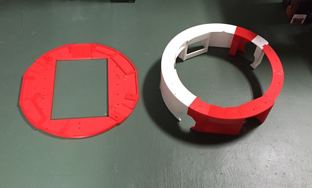

The second of the 3 rings is made up of 25 individual parts.These parts are quite tall (about 8 inches), but are narrower so they take about 6-8 hours to print.
The sections where the shoulders are consist of 3 parts sandwiched together for strength.
here is the progress so far on the second ring
The large print bed of the Raise 3d is perfect for printing this

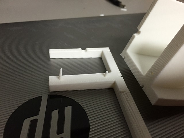

yes I am pretty amazed at the quality of the 3d files.Everything fits together really nicely and there are tons of tiny holes in the parts for you to put little pegs in to lock everything together.The larger parts also have holes drilled into them so you can use nuts and bolts to fit the parts that will carry weight together.

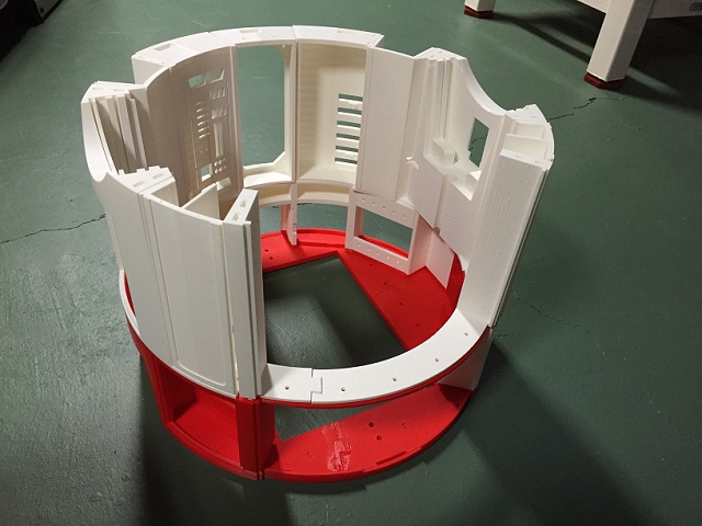

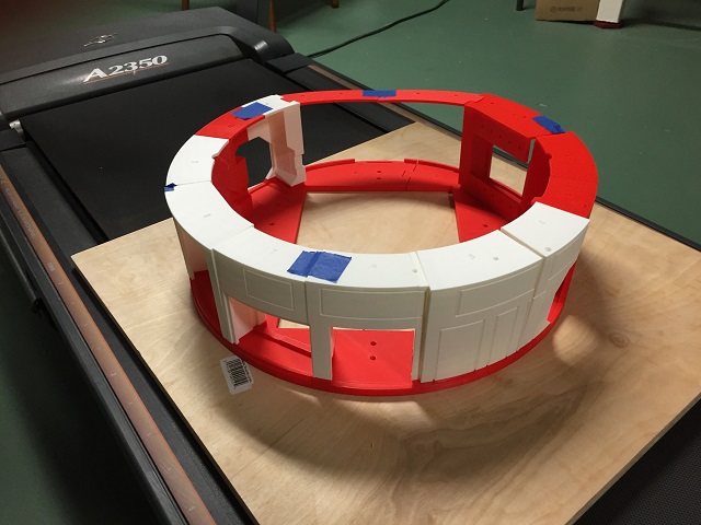

More work on R2.I have glued the base together and started on the first ring gluing.The second ring has also been printed.The second ring consisted of 22 parts and too about 250 hours to print.
The parts fit together very well.There are holes in each part to insert the 1.75 mm filament to aid alignment of the parts.
#18 Posted : 03 July 2017 18:07:46

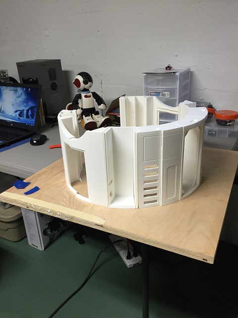

More work on R2.
The base is now epoxied together and so is the first ring.The second ring is printed and I have also started on the 3rd ring.There are metal rods that are installed on some parts of the second ring which are hinges for the doors.All of the doors on r2 will be operable via servos.you have to insert the metal rods before gluing the ring parts together.
