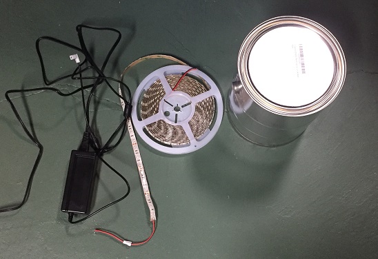

Since the resin requires UV light to fully cure ideally you should use a curing oven to expose the print to UV light.Putting the part in sunlight would work, but in my part of the world it gets pretty cold in the winter so I figure a curing oven would be a good idea.Formlabs makes one, but it is really expensive.Some people use curing stations that are used on nail salons, but these are pretty small. I found a blog where a guy made his own curing oven.So I gave it a try and for $50 I made my own curing oven.
Here are some pictures
