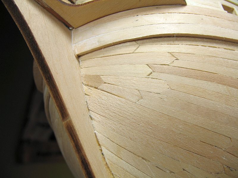

this is how I did it.
Greetings, Timm

Very neat! Thanks Timm.
How do you decide to use 2 droppers in a row? (3rd dropper down)
Mr.Quist
#12 Posted : 20 July 2011 23:00:25
Joined: 25/08/2010
Posts: 170
Points: 537
Location: Germany
Simply the planks themself told me what to do.
Keep holding a loose plank against the last on and bend it softly against the bow. You have to keep the plank flush to the ribs und mark that point, where it crosses the last plank. The balsa fillers really helped to see where I was about to run into the stairway effect.
In my case, the bending of the bow was so strong, that I needed droppers in every row until approx. row 17 (below the waterline).
Hard to explain this in english (sorry)
Darron explained it in his build diary here
Hope it helps.
