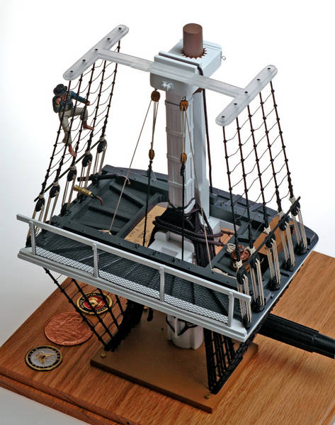

#8 Posted : 19 July 2011 15:58:45
Looking at this image it does appear to be in keeping with the norm
Many thanks for your reply Tomick. Looking at the interesting picture I notice there is a lip around the center, which would trap any rain and make it a pretty bad place to seek any protection from rough seas.
Believe you are right, possibly only for strength.
