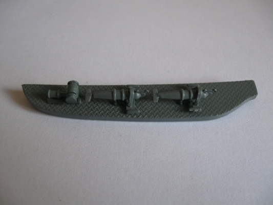

Stage 6 - Contains two 5-W keel sections, reinforcing plates, paravane platform, paravane's, winch and photo-etched brass railings.
A 'Paravane' is are a form of towed underwater "glider", initially developed to destroy mines, the paravane would be strung out and streamed alongside the towing ship, normally from the bow. The wings of the paravane would tend to force the body away from the towing ship, placing a lateral tension on the towing wire. If the tow cable snagged the cable anchoring a mine then the anchoring cable would be cut, allowing the mine to float to the surface where it could be destroyed by gunfire. If the anchor cable would not part, the mine and the paravane would be brought together and the mine would explode harmlessly against the paravane. The cable could then be retrieved and a replacement paravane fitted.
Start by adding the two 5-W keel parts to the base plate, then add the reinforcing plates between frame 17 and the slots for frame 18, the reinforcing plates should be clamped in place.
Carefully cut the two end lengths from the railing length as shown in the step 5, then form one large and one small hoop around the lengths of dowel supplied, glue the overlap joints and the locate the smaller hoop into the centre of the larger hoop to form the antenna ball shape.
File any burrs from the supplied cast metal parts, then prime and paint the parts along with the antenna and length of railing.
Mark the positions of the two Paravane's and glue them in place upon the platform, also glue the antenna onto its support already secured to the top of the island, (you may want to consider leaving the securing of the antenna hoop until the railing's have been added).
The railing lengths needs to be cut into 5 measured lengths as shown in the steps marked A-E, the lengths are then formed to shape in the positions shown on the island, and bend the feet of the railing stanchions to 90 degrees, which form the railing supports. Then glue each of the railing's in place on the island.
That's it for stage 6, carefully store the assembly.
