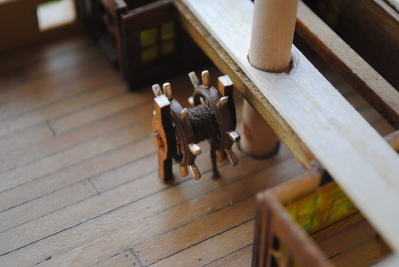

I have just thought of something,i take it we are coiling the wheel? if so would it not be easier to do it before the Poop Deck planking is fitted,it will be quite difficult to do it after.
I hav'nt seen or heard "THE HOLY ONE" mention this, what do you all think?.

That sounds like a good idea Glen...If there is no reason why it wasn't suggested or done before, it is well worth doing mate...Blink

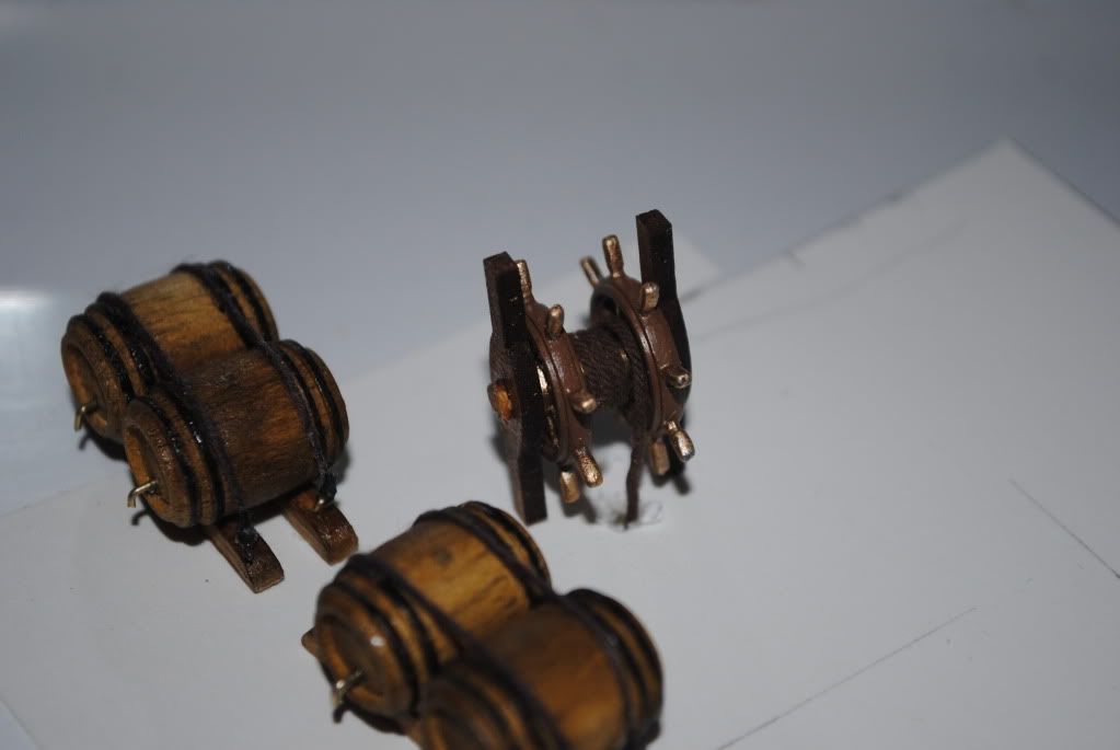

I coiled the wheel before fitting to the deck. and drilled holes for the rope to go into, also soaked rope in thinned wood glue to stiffen and fix it.

Just looked at some photo's of Victory's wheel and the the rope thats coiled around the drum dos'nt go straight into the deck, there seems to be some sort of timber battens running either side of the wheel and the rope go's into this first. any thoughts on this?.

Yes, Glen you are correct. If you have Jase "Quarter Deck Detail Pack" you can see the arrangement.
If the rope goes though a fixed hole it will wear the rope down. The arrangement is a slot in the deck and the boxing around the slot with a sliding section with the hole in it which slides and follows the rope when it wound onto the hub or unwound from the hub. This sliding plank is keyed into the surrounding box. This arrangement helps to stop water and other objects from falling through the slot.
