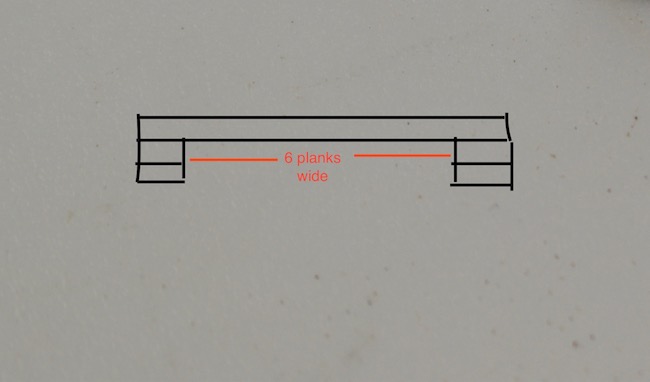

Another way for you to do it is Take a plank longer than the 6 planks. get 4 off cuts glue one on top of each other . leaves you with 2 pieces.
Now glue one to one end of the plank then the other 6 planks gap. you can then use that as a gauge.
Other than that way , if you have an electric plank bender then bend the peice as described in the instructions and it shouldn't break.
Chris

ronald305
#3 Posted : 26 July 2018 20:30:43
Joined: 08/02/2015
Posts: 426
Points: 1,259
Location: Louisiana
thanks Chris
that idea is pretty good but I was trying both the crimping tool and the iron
idea I might have been pushing to hard but also not knowing where to apply the
bend as well
Ronald
