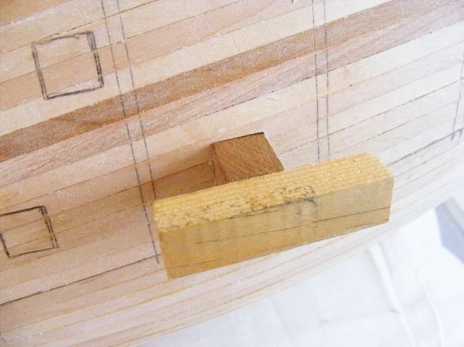

Hi Ronald, normally I check the ports by making up a jig. Made one up from a wooden strip that was 12x12mm…..

I've tried to make one out of pieces of tin first then out plywood left over from the bow fillers, I will try to make one like you have in the picture
