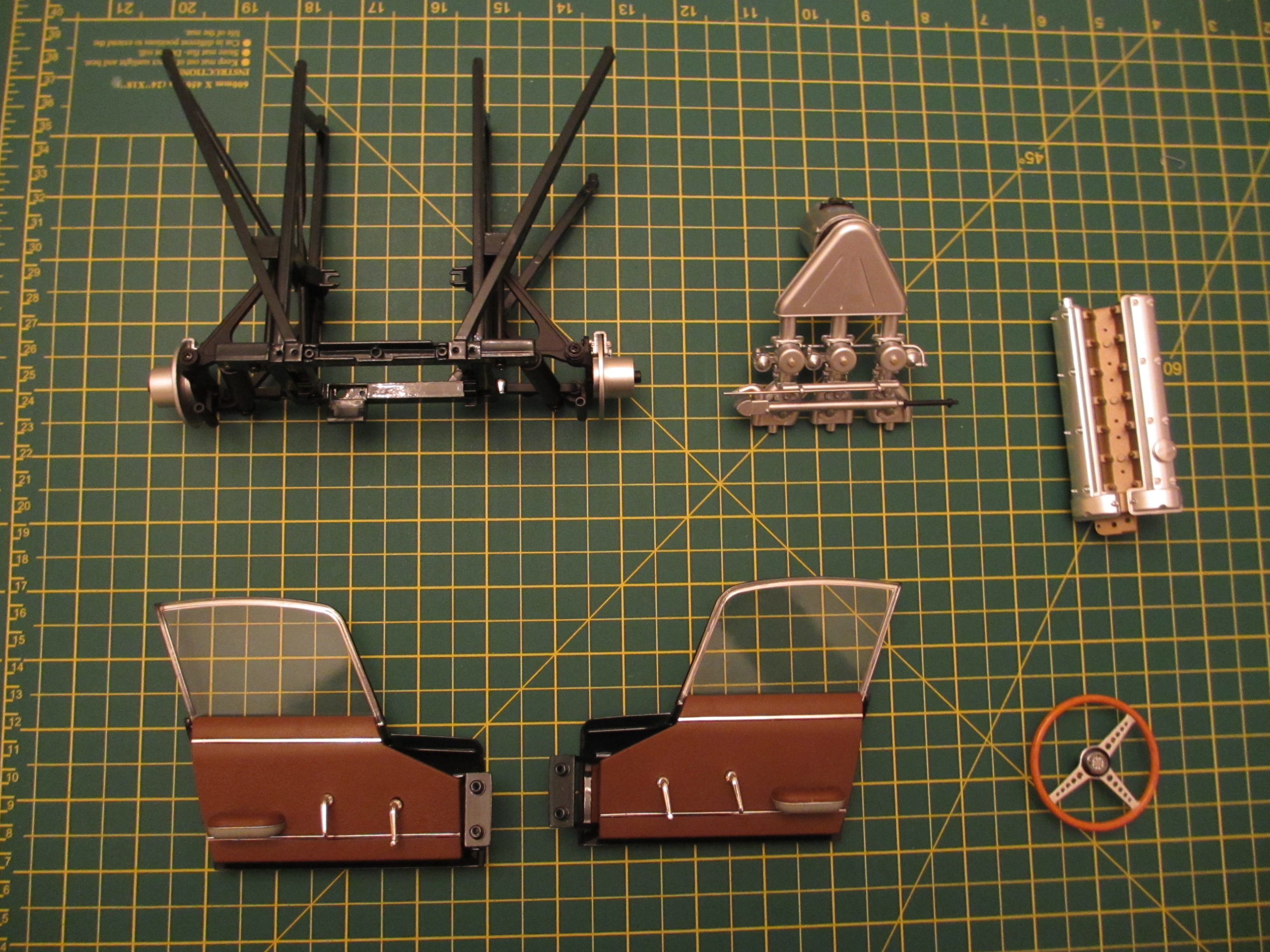

#10 Posted : 12 October 2018 23:43:03
Rank: Newbie
Joined: 11/10/2018
Posts: 4
Points: 12
Location: Reading, UK
I started the build yesterday and have a few parts assembled so far. I've identified the parts to paint so I'll do those in one hit then have a go at one of the wheels. Still trying to get my head round the difference between the 2 & 3 spoke methods. Here's what I've done so far...
