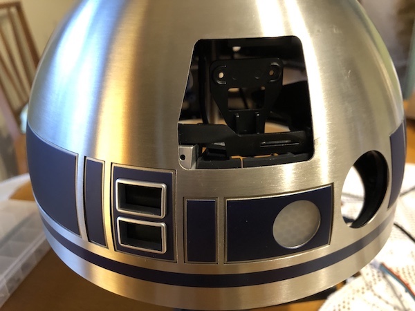

Hello there,
I have discovered today something very bad for my project. As you can see from the pictures there is a problem with the big hole on the dome, the one for the camera. I have received with issue 51 the dome and as you can see it is the wrong dome. From the official buid the hole must be in different position as it is not on my Dome. Wrong hole from the factory perhaps. Please help.

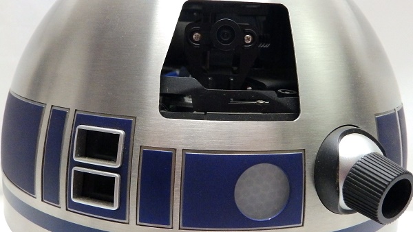

This is the oficial right version of the hole
Nicholas
Wrong Picture.jpeg (86kb) downloaded 161 time(s).
nsotiriou attached the following image(s):

Just to be clear, OP's camera hole in the dome extends left until the left-hand edge is almost aligned with the two-display panel.
The correct dome has this left-hand edge about halfway along the smaller, non-display, blue panel underneath it (the one in between the circular hole-cut panel and the two-display panel).
Sometimes I find it hard to spot the actual problem, so I thought this might help :-)

oh wow, this isn't great.
before you get carried away stripping everything, i would slide the lens cover in place and see how it looks. if it covers the gap, and the camera mounting position looks good then everything should be ok. its difficult to tell if the cut out is in the wrong place, or just been cut a bit too big.

Looking at the two pictures, it seems the hole is cut too far to the left; it looks the same size though, based on where the right-hand edge aligns.
Wrong Dome
Right Dome

Yes and that’s why it is impossible to put the blue eye correctly. The inner section of the Dome is ok.

i saw that, but the spacing on the opposite corner to the projector hole looks the same, which made me wonder if it was just the hole cut too big? as i mention, try fitting the eye cover. if its bad then deffo you need a replacement dome. if its ok, and hidden then just go with it. it looks like we fill the space with some foam strips in the future anyway. at the end of the day, the eye piece connects to the inner framework, so if thats ok, then there shouldnt be too much of a problem if the part covers the hole.

In stage 10 you get the 'Camera Lens Mount' that has slots in it that marry up with the slots in the dome frame, you can see the lower slot in the pictures. The lens mount can only travel from right to left when fitted to the dome until it locks in place. The cut out in Nicholas's Dome is too far to the left so there will be a gap on the left side when it locks in place.

nsotiriou wrote:
It is clear....
wow, i see what you mean. gutted for you mate thats pretty bad OhMyGod . shame you didnt spot it sooner . good luck with getting the replacement and swapping over. as suggested, get some decent 3m double sided tape for re sticking the panels in place and it shouldd be ok.ThumpUp
