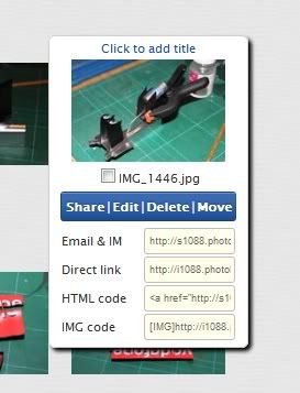

The easiest option is to create yourself a free photobucket account & then upload the pictures to that album.
Then in photobucket there is an option on each picture to copy the IMG code into your clipboard - like this:
Then paste the link or links into your post & they will look like this:
Code:
[IMG]http://i1088.photobucket.com/albums/i324/kryten2b/IMGcode.jpg[/IMG]
Then you can post the diary & the images will be shown within your post BigGrin
