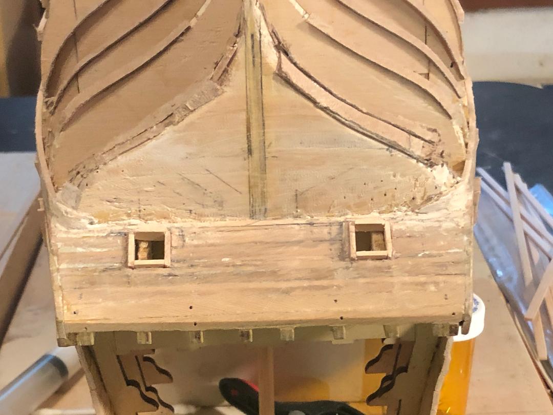

HI there
I know this post is a few years old but I also have the same issue that Sinbad
had with the planking of the stern, I feel that something is not right, so I
included two photos one is close up if any one can spot the problem if there
is one I would appreciate it if someone can explain to me what to do or how to
fix to help in any way I measured the distance from the bend of plank #5 on the
left to the end of the false keel to be 40mm, so # 5 plank on the right should
come out to be the same right, PS if I have to remove a plank or two to fix the
problem I will, also this question is for Alan in general should there be 9
planks that go across the stern when they reach the false keel. thank you
Ronald

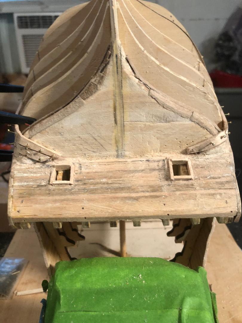

hello there
may I ask why no one wants to help me with the issue of planking the stern
area I had ask for help 5 days ago Alan was nice enough to help a little by
telling me he used only 8 planks to reach the false keel, anyway first I showed
photos of the problem I am having because everyone wants to see photos in order
to help but no one responded, so I removed the planks and cardboard shims in
order to start over still no responds, so I started over and trying again to
planking on both sides as you can see from the new photos I just can't seem to
get the stern planks to look like the one in the instructions or in Alans build
video, I would hate to have to remove them again I don't want to run out of
planks till I get it right, so I would appreciate someone honoring me with a
helpful suggestion or something this time, I can do it I just need direction.
P.S. one question how to select the right plank for bending a few have been
cracking when I try to bend them and they have been wet as well
thank you
Ronald

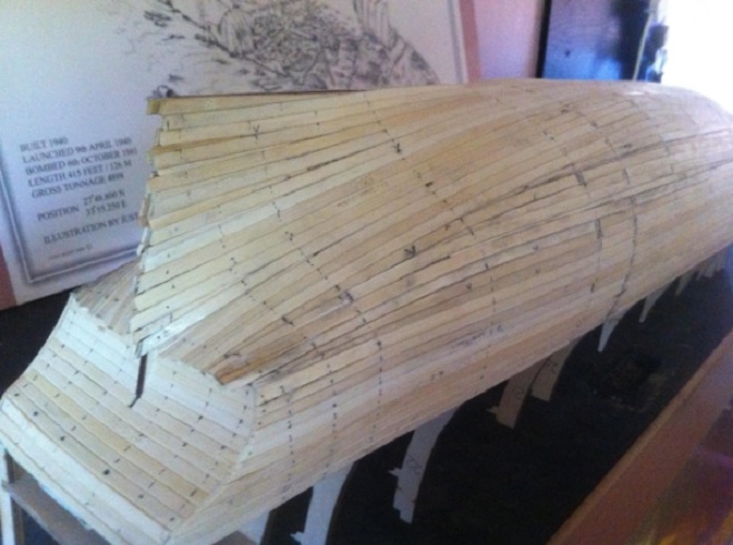

#6 Posted : 17 September 2020 16:36:02
Hi Ronald, BigGrin
I have only fully planked one model and that was the SOTS.
There is a glaring difference between how different ships are planked. With the SOTS the planks were not shaped around the stern. They went to the stern rib, butting up to the stern planks that were flat across the stern.
You also have to take into account that lots of people build these ships and are confident doing that, but when asked to assist in somebody else`s problem they don`t have the confidence to give a reliable answer. Hence do not reply.
Now that said I`m going to offer some advice that Alan may rebuke later. He is a much better ship builder than I will ever be, how ever long I live.
Having looked at your pics, it seems you have had some issues with the fairing of the ribs toward the stern of your build. Hence the need for the added packing.
For my first ship build of the SOTS and as a total novice I used lots of balsa infills between the ribs to guide me where the fairing needed to stop to give the best shape. Even then there was lots of lovely sanding to do when the planking was complete.
I have attached two pics.
1: Shows the difference in stern planking.
2: Shows the balsa infills that went almost up to the stern end ribs to give me the best shape.
Hope this gives you some ideas. I don`t give any assurance of a cure for your problem, but that`s the best I can offer.
Check back to see if Alan agrees or disagrees. Take his advice over mine any day.

#9 Posted : 17 September 2020 17:16:48
ronald305 wrote:
HI Derek
well the first photo showed up but the second photo is missing
Ronald
Hi Ronald, BigGrin
If you click on the page refresh button, maybe a few times it should show.
Not a problem at your end, a forum issue.
ronald305
#10 Posted : 17 September 2020 17:24:12
Joined: 08/02/2015
Posts: 426
Points: 1,259
Location: Louisiana
ok thanks Derek
they both finally showed up, question about the second photo is that a piece
of balsa block used as fillers they look like Styrofoam
Ronald
#11 Posted : 17 September 2020 17:31:53
ronald305 wrote:
ok thanks Derek
Ronald
Hi Ronald, BigGrin
Understand what you are saying.
Balsa comes in a variety of density`s.
I was lucky enough that at the time I started the SOTS, my wife knew a college lecturer who built RC planes and had loads of scrap Balsa that he donated to my building cause of the SOTS.
The denser the balsa the darker the colour, but I can assure you its balsa.

#14 Posted : 17 September 2020 21:18:26
Hi Ronald, think we'll have to deal with this in stages but would first say the reason your planks are cracking or breaking when bending is probably because the plank may be wet but in all honesty the planks need to be soaked. Second reason is probably because you are trying to bend the plank at the end of the plank to get it around the sharp curve. Soak your plank, then bend the plank around 3 inches from the end of the plank rather than at the end, cutting off the excess later.
The planks you laid are coming around the stern too shallow and as a result there is no way you will get 8 or 9 rows laid before hitting the keel. It looks to me as if the first plank you laid going around the stern has simply been bent around the stern whereas the instructions do show that you need to add a slight twist and the edge of the plank needs to have a heavy chamfer. The twist helps to cover the filler on that corner but also means the end of the plank will steeper.
You really only have two choices, the first is to continue as you are and accept the fact you won't get 8 or 9 rows before hitting the keel. As long as both side are symmetrical then it shouldn't look to bad. It may mean a lot of filling later in the build but if your are painting the hull then it should all be covered up.
The second choice is to strip it all back, get the fairing of the stern sorted then fit the first plank around the stern following the instructions to bend and apply the twist. This first plank is probably the hardest part of the build to get right and many modellers have found this to be problematic but with a little patience I'm sure you get it right.
We will also see if we can source you some additional planking strips, will get back to you on this one.

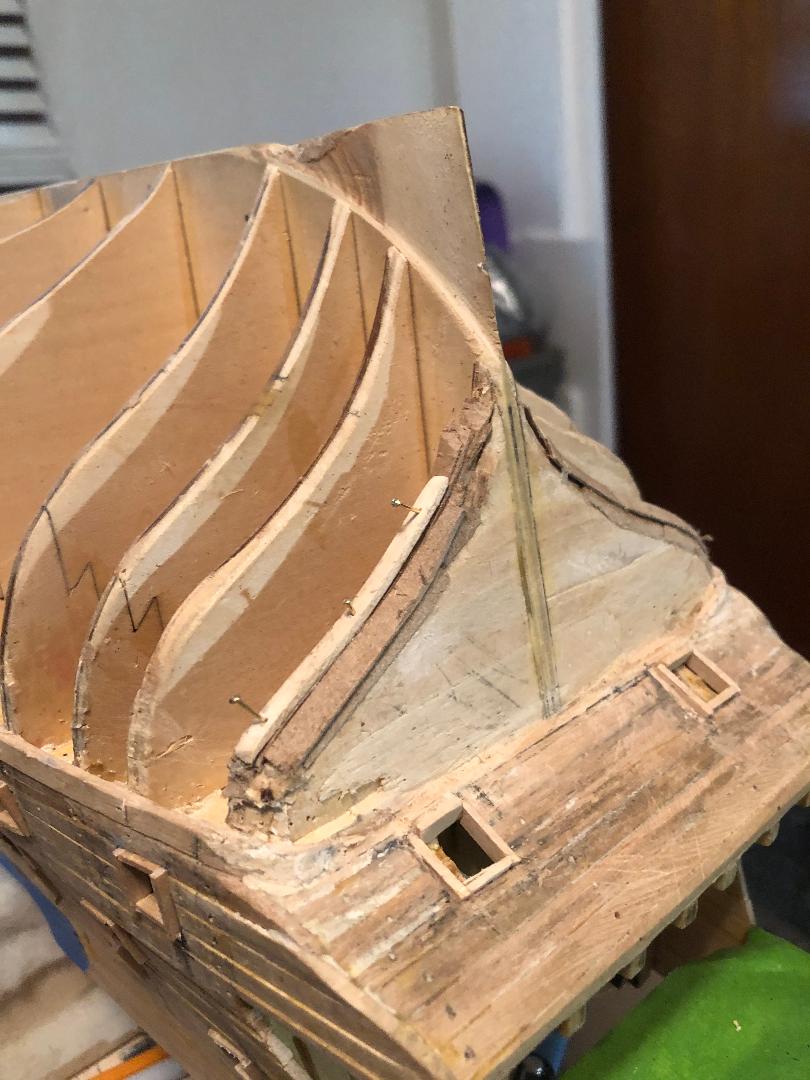

Hi Alan
before I attempt to re-plank the stern properly this time may I ask how do I go about sorting out the fairing which I believe I have faired it to much especially
I notice I put to much turn in the false feel as you will notice in the photos by the way please forgive the mess I made when I removed the planks the third time around it's not pretty I will clean it up once I figure out how to fix the fairing on the stern thank you
Ronald

Hi Alan
could you explain to me what you mean by the planks are coming around the stern
to shallow, and should I remove the first planks, because I was hoping it could
be saved but if the stern needs to be built up and faired correctly which mean
starting where the first plank goes al the way to where the curve was sanded
in to the false keel, which bring me to my next important question how do I go
about faring the last bulkhead/stern or transom correctly assuming that I did
faired the stern to much. PS disregard the messy build up on the stern I removed
it all and will try to build it up better once I hear back from you thank you
Ronald
