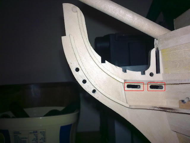

Hi Rossy,
I had the same problem, and then I noticed that I didn't line up the holes in the stem and the hole in the stem reinforcements completely - I decided to remove and refit the stem reinforcements (which needed about 1mm trimmed off it to fit) and the dolphins.
The red outlines in the pic below shows the holes which I'm talking about
#6 Posted : 11 January 2012 08:29:15
Ahhh now you have said that i remember I had to shorten mine quite a bit to align the slots. that's the probable issue. BigGrin
