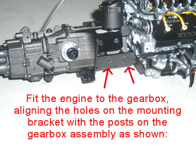

Retrieve the engine and gearbox assemblies from the previous stages.
#7 Posted : 21 November 2024 10:38:17
Posts: 5,862
Points: 17,738
STAGE 50B:
Fit the bracket on the gearbox assembly to the two upper shafts on the left gearbox housing, part 50A.
Fit the bracket on the engine assembly to the two lower shafts on the gearbox housing, part 50A.
Fit the right gearbox housing, part 50B in place and fix the entire assembly together using 4 x DM screws through the holes in the side of the gearbox housing.

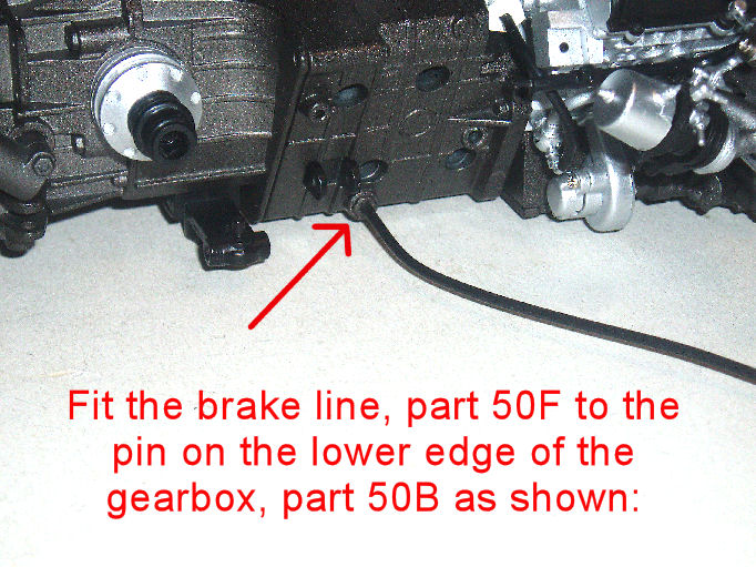

Fit one end of the brake line, part 50F to the pin on the lower edge of the gearbox housing, part 50B.
Fit one end of the other brake line, part 50F to the pin on the lower edge of the gearbox housing, part 50A.
