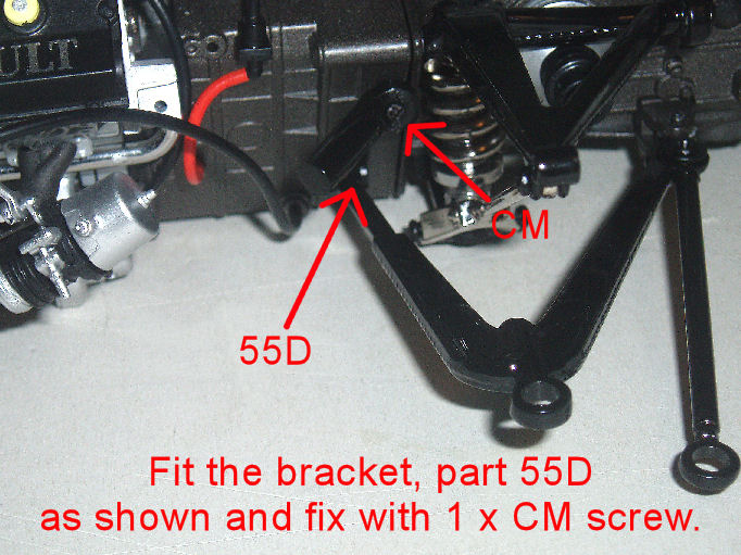

Locate the control arm, part 55A and fit the ‘Y’ shaped end to the bottom of the shock absorber mount, part 49B.
Secure from each side using 2 x DM screws.
Fit the other end of the arm into the end of the upper suspension arm, part 54A and secure using 1 x DM screw.
Locate the two lower arm parts, 55B and 55C.
Fit 55B to 55C, making sure it is angled upwards.
Secure using 1 x KM screw.
Fit this assembly to the lower edge of the transmission with the ‘O’ shaped connector fitting in between the two tabs on the transmission case, part 50C.
Fix using 1 x LM screw.
Take care here as access for fitting this screw is limited.
Fit the other end of the suspension arm 55B/55C into the two tabs near the rear of the transmission case, part 48B.
Fix using 1 x JM screw from underneath.
Fit the bracket, part 55D to the locating point on the transmission case, part 50A and fix with 1 x CM screw.
