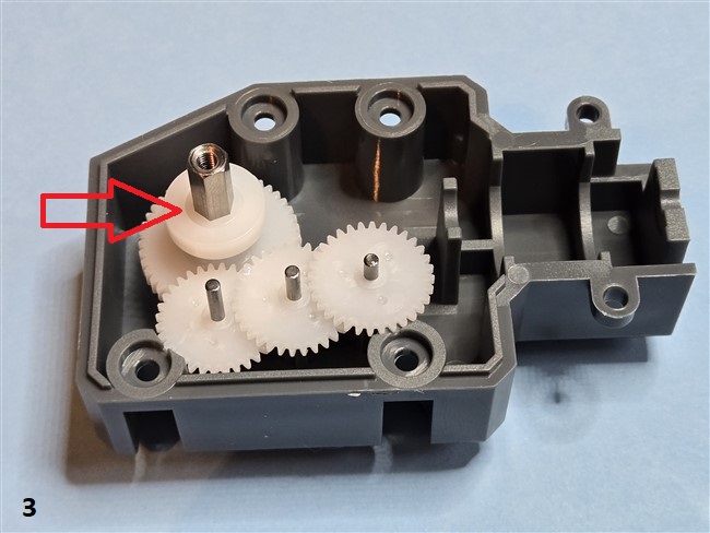

Bring the assembly from the end of Issue 56 to the table and remove the upper nylon bearing above the large gear. Then add the three shafts 57-02 and three gears 57-01 as shown in Pic 2. Don`t forget to grease the gears as you go.
Finally replace the large nylon bearing we removed earlier, as shown in Pic 3.

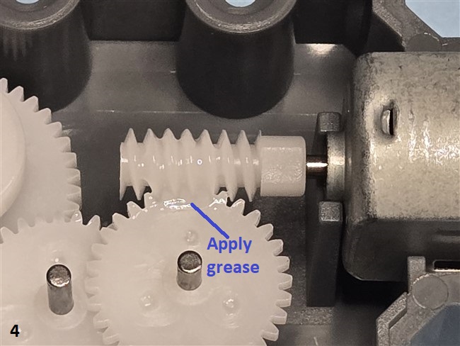

#2 Posted : 12 February 2025 14:38:20
Hi All, BigGrin
I`ve managed to get some progress on this build inbetween everything else that`s happening at present.
So here we go with Issue 58.
Parts supplied.....Pic 1, you will also need the assembly from issue 57.

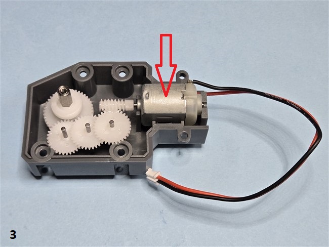

Press the worm gear 58-02 (smooth end first) onto the spindle of the motor 58-01, using the measurements shown in Pic 2.
Now position the motor into the gearbox from issue 57 as shown in Pic 3. Finally apply some of the supplied grease as shown in Pic 4.
That`s all for this update, so I`ll be back asap with issue 59.
(Derek) Admin

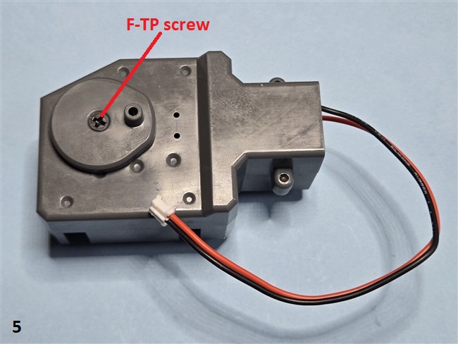

#3 Posted : 13 February 2025 16:25:46
Hi All, BigGrin
Time for the update for issue 59.

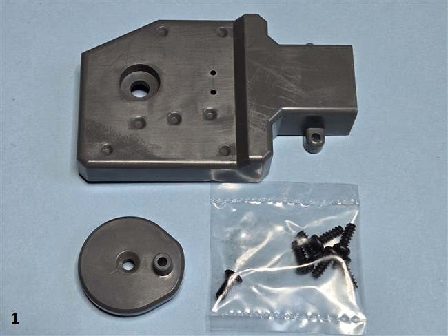

Parts supplied.....Pic 1, you will also need the assembly from issue 58.

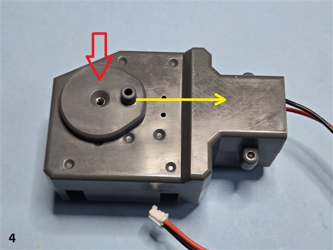

Place the assembly from issue 58 on your table and add the cover 59-01. Also check the position of the shaft that comes through the hole, as shown in Pic 2. Adjust the position of the main gear if needed.
When you are sure the parts are correctly aligned, secure the two halves of the box together using 6 x P-TP screws as shown in Pic 3.
Now position the arm crank 59-02 as shown in Pic 4 and fix it in place using an F-TP screw as shown in Pic 5.
See you soon for the issue 60 update.
(Derek) Admin

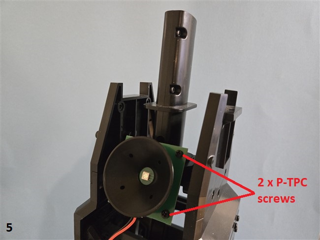

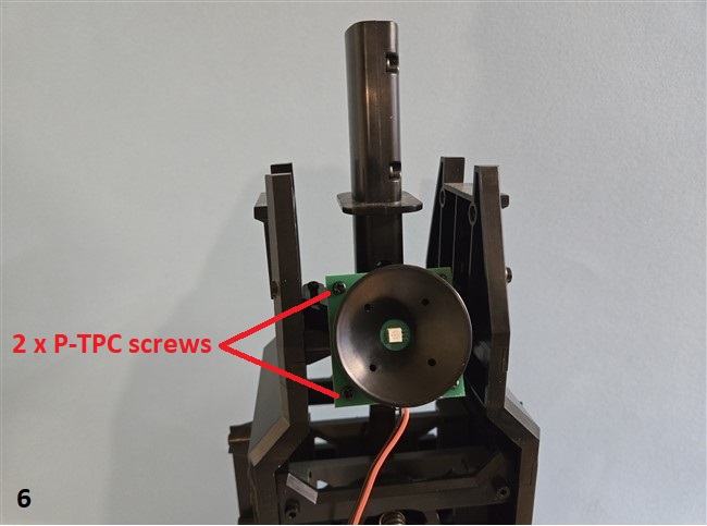

Start by placing the reflector 62-01, onto the chest circuit board 62-02 as shown in Pic 2. Then, hold the parts together and fix them using 4 x P-TPC screws as in Pic 3. Now insert one end of the cable 62-03 into the socket on the board 62-02 as shown in Pic 4.
Now fix the assembly from above onto ET`s body using 4 x P-TPC screws, two shown in Pic 5 and two in Pic 6.
