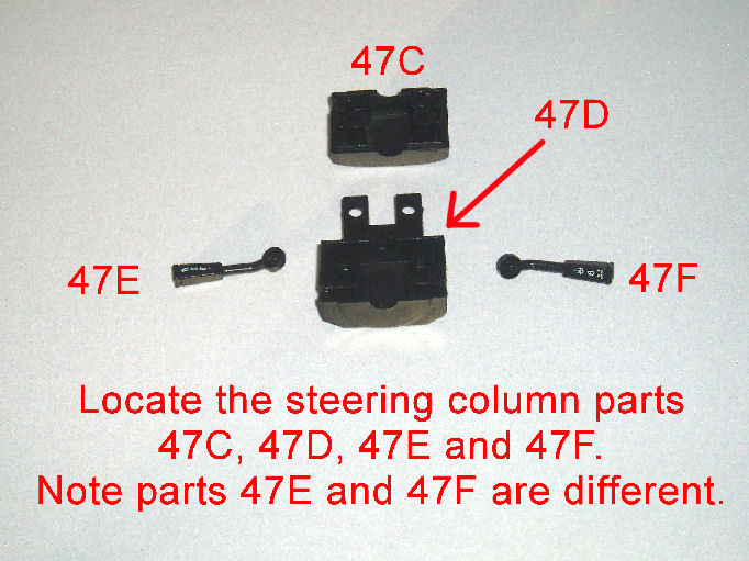

STAGE 47A:
Steering column and dashboard assembly.
Locate the steering column parts 47C, 47D, 47E and 47F.
Fit the two stalks, 47E and 47F into the column part 47C, noting they are different to each other.
The indicator stalk 47F goes on the right.
Fit the column base, part 47D in place and fix with 2 x BP screws.
Note they are incorrectly labelled AP screws in the printed instructions.
Fit the assembly underneath the main dashboard and fix with 2 x FP screws.
Fit the small bracket, part 47I onto the curved slot on the dashboard base, part 47A and secure with 2 x BP screws.
Fit the assembly underneath the main dashboard and fix using 4 x FP screws.

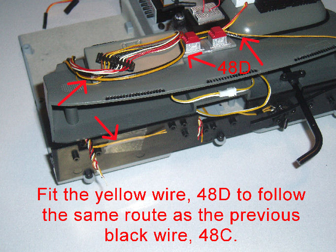

STAGE 48A:
Dashboard wiring.
Locate the wires 45C and fit them in place on the top of the dashboard.
Feed the wires down the front of the dashboard and under the centre console to exit at the rear.
Feed the wires and plug, part 43A out at the rear of the centre console.
Locate the floor assembly and fit the dashboard and console in place.
Fix the parts together with 4 x FP screws from underneath.
Locate the separator and wires, parts 48A and 48B.
One at a time, feed the wires through the separator in the correct colour order, so that there is approx. 14cm of wire on each side.
#4 Posted : 24 February 2025 16:50:24
Posts: 5,856
Points: 17,720
STAGE 48B:
Twist the ends of the wires into a ‘bunch’ and then fit the separator to the top of the dashboard.
It will only fit one way.
Feed the 1st ‘bunch’ of wires near the centre of the dashboard down the front and under the dashboard to exit at the rear in the centre.
The other wires feed down the front of the dashboard on the right, under the dashboard to exit at the rear.
Locate the wires 45C and 45D and fit them in place behind the four red connectors on the top of the dashboard in the middle.
Feed the wires along the top of the dashboard on each side, down and underneath to exit at the rear on both sides.

#6 Posted : 24 February 2025 16:58:54
Posts: 5,856
Points: 17,720
STAGE 48D:
Using the wire location illustrations fit all the wires at the top centre of the dashboard in place on the four red central connectors.
Fit all of the wires 48G in place on the connectors, part 45D in the correct colour order as shown.

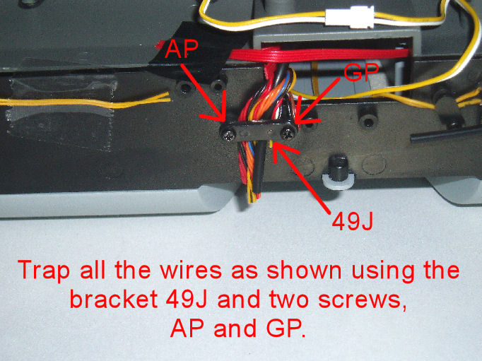

Locate the wires 49D, 49E and 49F and pass them all under the passenger side of the dashboard to exit through the central hole at the rear.
Fix the ends in place behind the dashboard using the bracket 49J and two screws, AP and GP. Make sure the AP screw is fitted on the left.
Locate the two black cables, 49C and pass them through the dashboard in the same way.
The ends with the grey fittings on are to the rear of the interior.
#8 Posted : 26 February 2025 11:53:39
Posts: 5,856
Points: 17,720
STAGE 49B:
Collect all of these fitted cables and secure them together at the end of the footwell with a cable tie, part 49K and cut off the excess.
Fit another cable tie on the wires just past the seatbelt but not beyond the floor panel.
Fit wires 49G and 49H together and secure with two cable ties at approx. 1/3 and 2/3 spacing along the length of the wires.
Cut off the excess cable ties.
Fit these wires under and through the dashboard as before, but this time on the driver’s side.
Fix the ends of the wires in place behind the dashboard using the bracket 49J and screws AP and GP, screw AP on the left again.
Locate all the wires coming through the dashboard on the left rear side and fix them in place using bracket 49J and two screws, AP and GP as before.
Locate all the wires coming through the dashboard on the right rear side and fix them in place using bracket 49J and two screws, AP and GP as before.

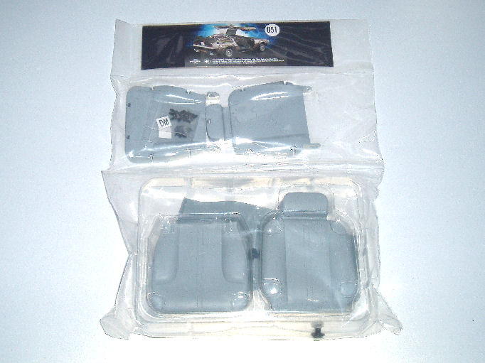

#11 Posted : 01 March 2025 11:51:19
Posts: 5,856
Points: 17,720
STAGE 51A:
Assembling the passenger seat.
Locate the seat back parts, 51B, 51C and 51D.
Fit the sponge, part 51C inside the seat back, part 51D and then fit the frame, part 51B inside.
Locate the seat base parts, 51C, 51G and 51H.
Fit the sponge, part 51C inside the seat base, part 51G and then fit the frame, part 51H inside.
Fit the two assemblies together and then fit one of the adjuster wheels, part 51F into the holes in the frames which must be aligned.
From the inside, secure the parts with 1 x HP screw.
#12 Posted : 01 March 2025 11:54:35
Posts: 5,856
Points: 17,720
STAGE 51B:
Repeat this on the other side of the frames with another wheel, part 51F and 1 x HP screw.
Fit the seat back part 51A in place and secure with 5 x DM screws.
Fit the seat base part 51E in place and secure with 4 x DM screws.
Fit the seat to the passenger side of the interior taking care that the wiring in neatly trapped against the transmission tunnel and the seat belt is properly in place.
Fix the seat from under the floor using 2 x HP screws.
