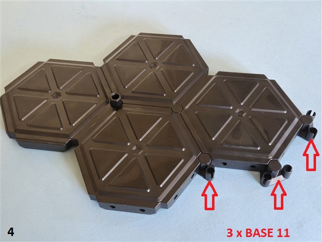

Now add the 3 x BASE 11 parts supplied to the base from issue 74, as shown in Pic 4. Turn the parts over and fix them with 4 x BIG AS8 screws, indicated in Pic 5.

Pic 6 shows the orientation of the two base sections (mounting posts included). Fit the two sections together as shown in Pic 7. Remove the mounting posts and fix the BASE 11 parts with a further 5 x BIG AS8 screws (arrowed in Red) and fit 8 x NUTS and BOLTS along the joint line marked in Yellow. See Pic 8.
Your base should now be as shown in Pic 9, so you can remount your model with the posts. Pic 10. See you soon for the next update.
