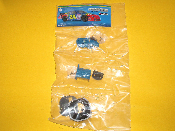

#4 Posted : 14 May 2025 10:22:43
Posts: 5,770
Points: 17,462
STAGE 8A:
Transmission case.
Pic 1: Fit the bracket 8C inside the clutch bell housing 8A as shown and fix with 2 x AM screws.
Pic 2: Fit the front plate 8B and fix with 3 x AM screws. The part will only fit one way.
Pic 3: Retrieve the right engine block 6D and fit the bell housing as shown, fixing it with 2 x AM screws.
Pic 4: Retrieve the left engine block assembly 6A and fit it to the right half 6D, securing the parts together with 2 x IM screws as shown.
Pic 5: Locate the transmission case body 8D and press the cover plate 8F into place.
It will only fit one way.
#5 Posted : 14 May 2025 10:27:55
Posts: 5,770
Points: 17,462
STAGE 8B:
Pic 6: Fit the bracket 8I to the case mid-section 8G and fix with 2 x BM screws.
Pic 7: Fit the drive shaft slip yoke 8J into the transmission case end 8H and fix from the inside with 1 x PP screw.
Pic 8: Fit the transmission case assemblies 8G and 8H together as shown and fix with 2 x AM screws from the inside.
Pic 9: Fit the transmission case 8D to the clutch bell housing on the engine assembly as shown and fix with 2 x AM screws.
Pic 10: Turn the assembly around and fit a further 2 x AM screws on the other side.
Pic 11: Fit the mid transmission assembly 8G in place and fix using 2 x AM screws as shown.
Pic 12: Turn the assembly around and fit a further 2 x AM screws on the other side.
Pic 13: Store all of the parts safely for now.
