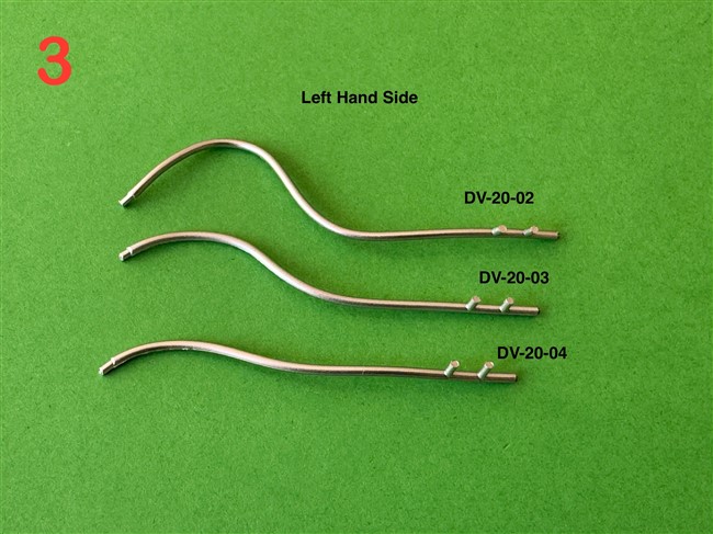

Warning: The magazine shows the next set of parts being attached to the neck frame assembly. The instructions are somewhat confusing and wrong in several places. I have detailed in this next section the correct way to install the inner wires that attach either side of the mask.
First, you will see that you have two bags of wires, each bag containing 3 wires. Take the left-hand side parts, the bag has a “L” on it. The individual wires have a sprue on the end of each one with its number on. Break off these sprues and lay them out on order as illustrated in picture 3.

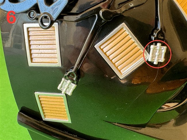

Take the first wire “DV-20-02” and attach it to the inside of the mask, pushing the two pins into the side wall and the end of the wire in the top of the three internal parts to the front of the mask, picture 4.
Take the second wire “DV-20-03” and attach the two pins directly under the first wire and the end into the middle of the front three internal parts, picture 5.
Fit the last wire “DV-20-04” in the same way, pushing the two pins into the bottom of the side wall of the mask and then pushing the end of the wire into the last bottom front part, picture 6.
