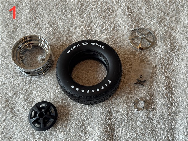

Issue 2
Fit the left wheel rim (2C) into the left front tyre (2A). Push fit it in from the facing outside tyre, making sure the tyre valve is facing outwards as shown in picture 2.
Press the front wheel hood mounting (2E) into the holes around the middle section of the inner wheel centre (2B), picture 3. Place the assembly into the centre of the wheel as shown in picture 4. Turn the assembly over and secure the inner wheel with 3 x “C” screws, picture 5.
Finally, place the front wheel outer centre (2D) into the inner centre, push fitting the three pins in place, picture 6.
