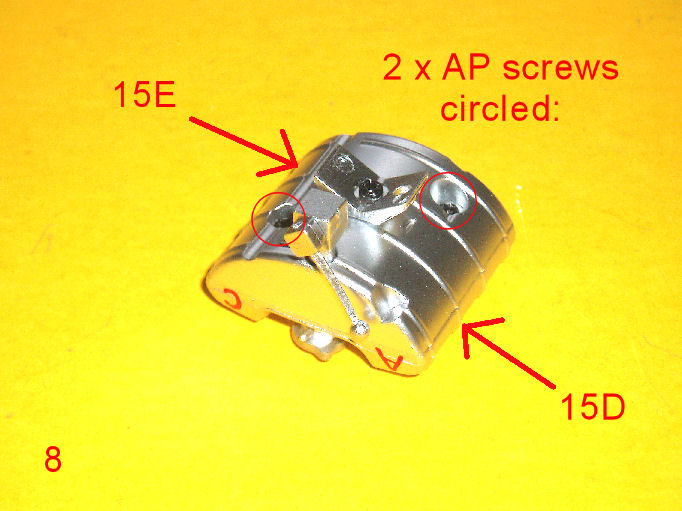

STAGE 15B:
Pic 7: Fit the cap assembly into the tank top 15D as shown and fix from below with 1 x KP screw.
Pic 8: Fit the two tank halves together and secure with 2 x AP screws.

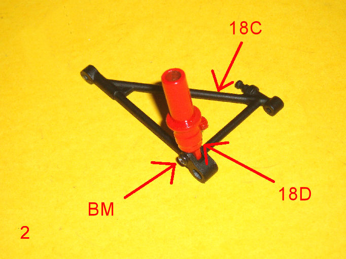

Pic 1: Press-fit the adjuster 18E into the side of the shock absorber 18D.
Pic 2: Fit the shock absorber to the swing arm 18C as shown and fix with 1 x BM screw.

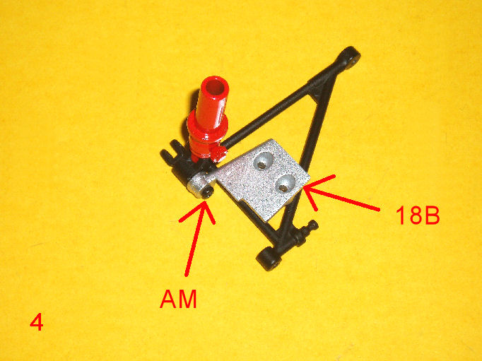

Pic 4: Fit the support plate 18B to the assembly as shown and fix with 1 x AM screw.

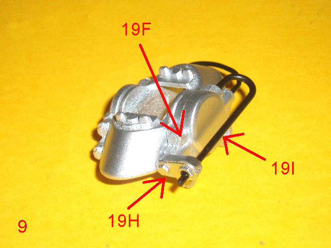

Pic 8: Fit the other brake pipe 19I in the upper hole on part 19F as shown.
Pic 9: Press-fit the small bracket 19H to 19F, also fitting it over the brake pipe 19I.

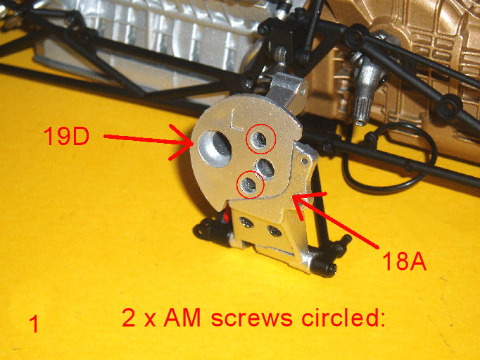

Pic 1: Retrieve the engine assembly and fit the brake back plate 19D to the upright 18A and fix with 2 x AM screws.

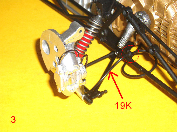

Pic 3: Fit the brake line 19K to the pin on the side of the frame as shown.

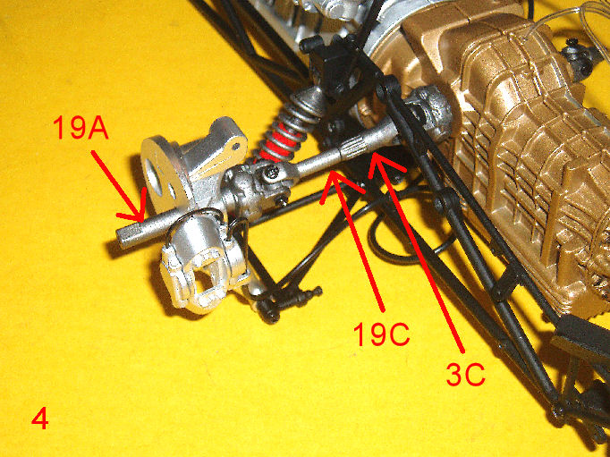

Pic 4: Retrieve the half shaft assembly from the previous stage and pass the longer end 19A through the hub upright.
Attach the other end 19C to the shaft 3C as shown.

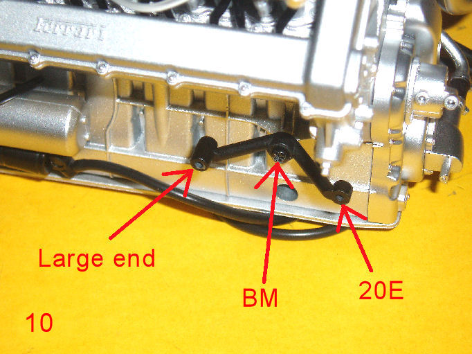

Pic 10: Fit the bracket 20E to the side of the engine as shown, fixing with 1 x BM screw.
NOTE – The printed instructions are incorrect.
The picture is correct but the text says to have the larger end of the bracket facing forwards. If this is done, the side frame will not fit later on.
