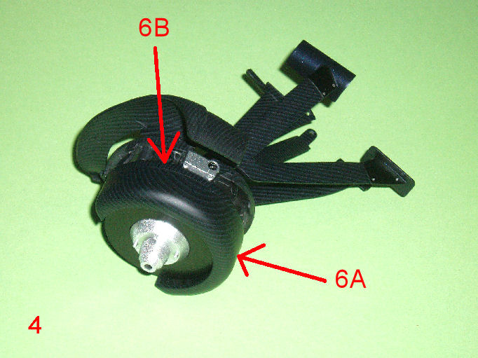

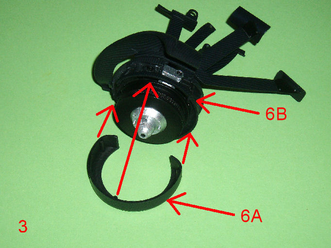

Pic 3: Locate the front disc cover 6A. This will fit to part 6B just fitted.
Pic 4: This shows the parts fitted together.

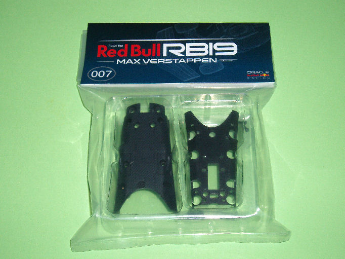

Survival cell.
Pic 1: Locate the two parts of the survival cell 7A and 7B.
7A will fit inside 7B.
Pic 2: This shows the parts fitted together.

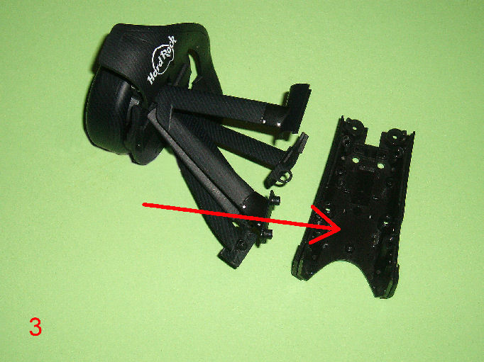

Pic 3: Retrieve the hub and suspension arm assembly from the previous stages.
This will fit to the side of the survival cell as indicated.

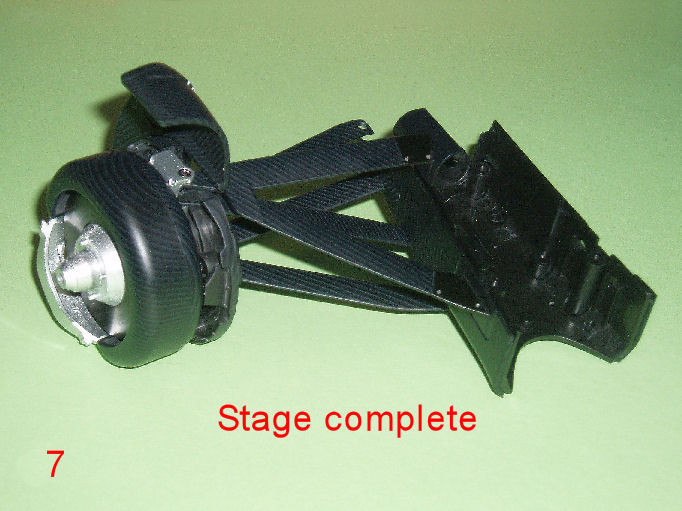

Pic 7: Shows the completed assembly.
Store the parts safely for now.

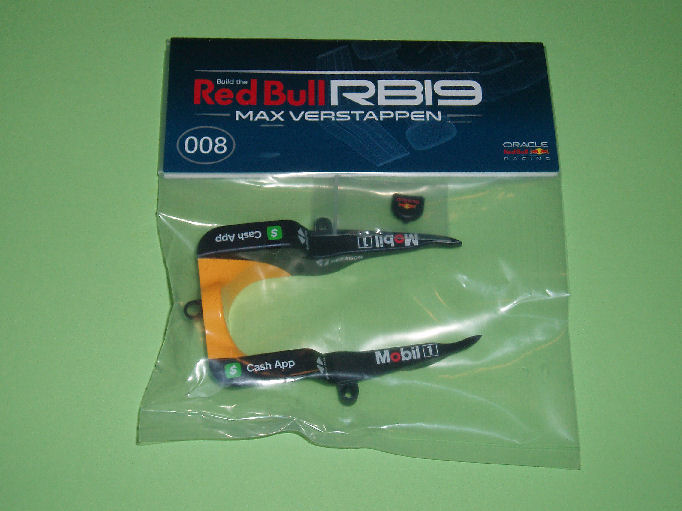

STAGE 8:
Headrest.
Pic 1: Locate the headrest and centre pad 8A and 8B.
The pad will fit in the two holes on the inner rear of the headrest.
Pic 2: Shows the completed stage.
