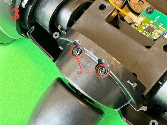

Issue 89
The Back Assembly
Connect the neck protector support (89D) to the lower neck joint as shown in pictures 2 and 3, securing it with 2 x QP screws.
Insert the neck (89E) as illustrated in picture 4.
