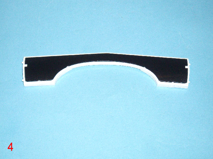

They will press-fit together.
Pic 4: Parts assembled.

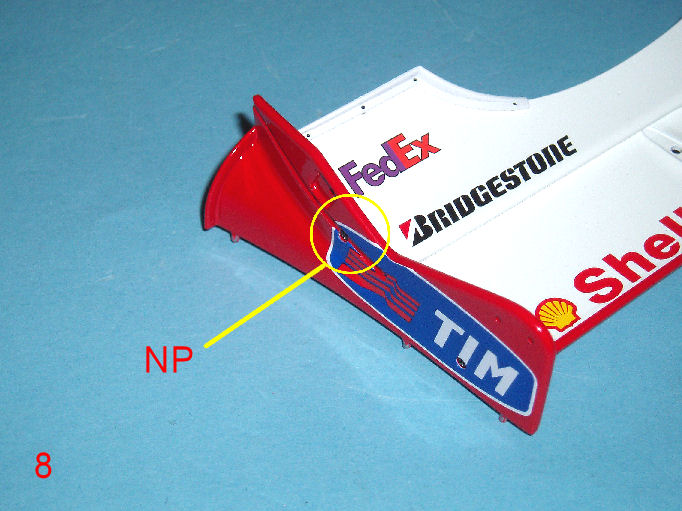

Pic 8: Fix at both ends with 1 x NP screw on each side.
