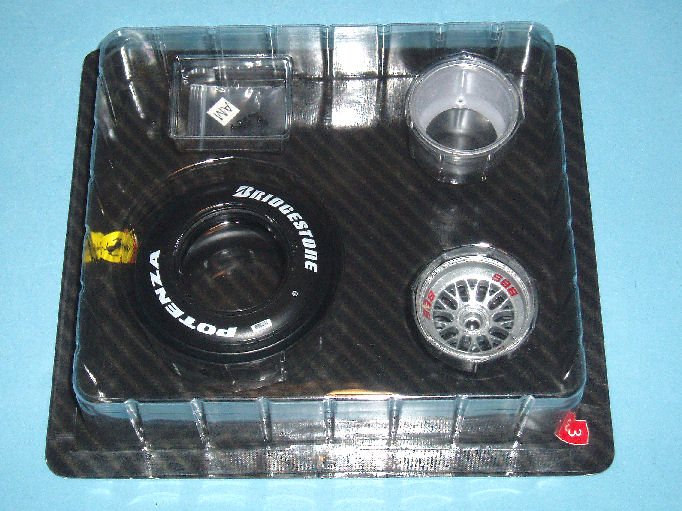

STAGE 3:
Front wheel.
Pic 1: Fit the rim 3B into the tyre 3A.
NOTE: The outside of the tyre has a bar code on it. (Highlighted)
The outer rim fits on this side.
Pic 2: Fit the inner rim and fix the parts together with 4 x AM screws.
Pic 3: Store the wheel safely for now.
