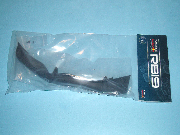

STAGE 95:
Left side fairing.
Pic 1: Retrieve the assembly from stage 36 and fix it to the left side of the car chassis as shown using 2 x W screws from underneath.
Pic 2: Store everything safely for now.
