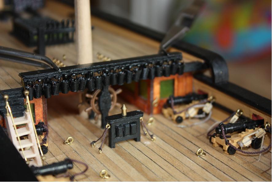

After my previous post regarding my method of making fire buckets the next step was to figure out a way to attatch my buckets to the rail on the poop deck
Attatched is a photo of my first attempt.
I constructed a small rail from a piece of 1.5 mil square wood, I then drilled a series of .75 mil hole at 4 mil intervals along the rail making a total of 20 before I ran out of space. I then inserted cut down pins (I seem to have a lot spare after planking the hull). Painted black to match the poop deck rail. It is my intention to glue this small rail under the top of that already on the attatched to the deck, but not just yet as I still have a lot of work to do on the deck area and these buckets will be easily damaged even though they are made out of lead.
Still working on a way to add the crown and GR on the buckets, dont fancy having to hand paint the lot so I may go with just leaving them painted black
As always feedback is most welcombe
