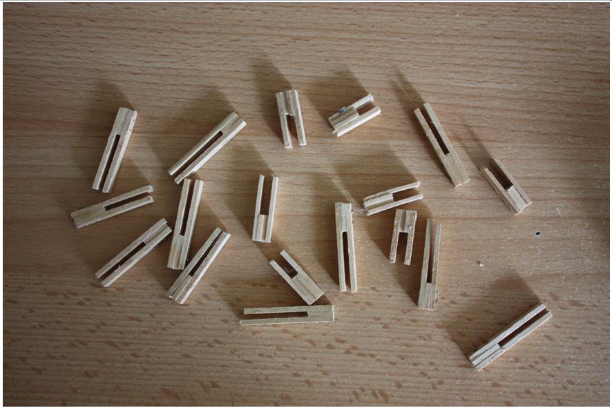

The Victory is my second build the first being The Bismark.
I must admit the scale and build of the Vistory does present different challanges.
When it came to fitting the deck planking I avoided using the pins mainly because of the problems of marking or splitting the planking.
My solution to the problem was to construct a number of pegs from some of the planking material (I found their was plenty provided)
Some are the thickness of the planking and some double size. I used these to hold the plank firmly to the cross beams and to the adjacant plank. Just be a little careful not to add too much glue to the plank as you dont want to glue the pegg as well. Worked for me. You must need to pine the final planking as you get close to the hull.
As they say a picture speaks a thousand words
