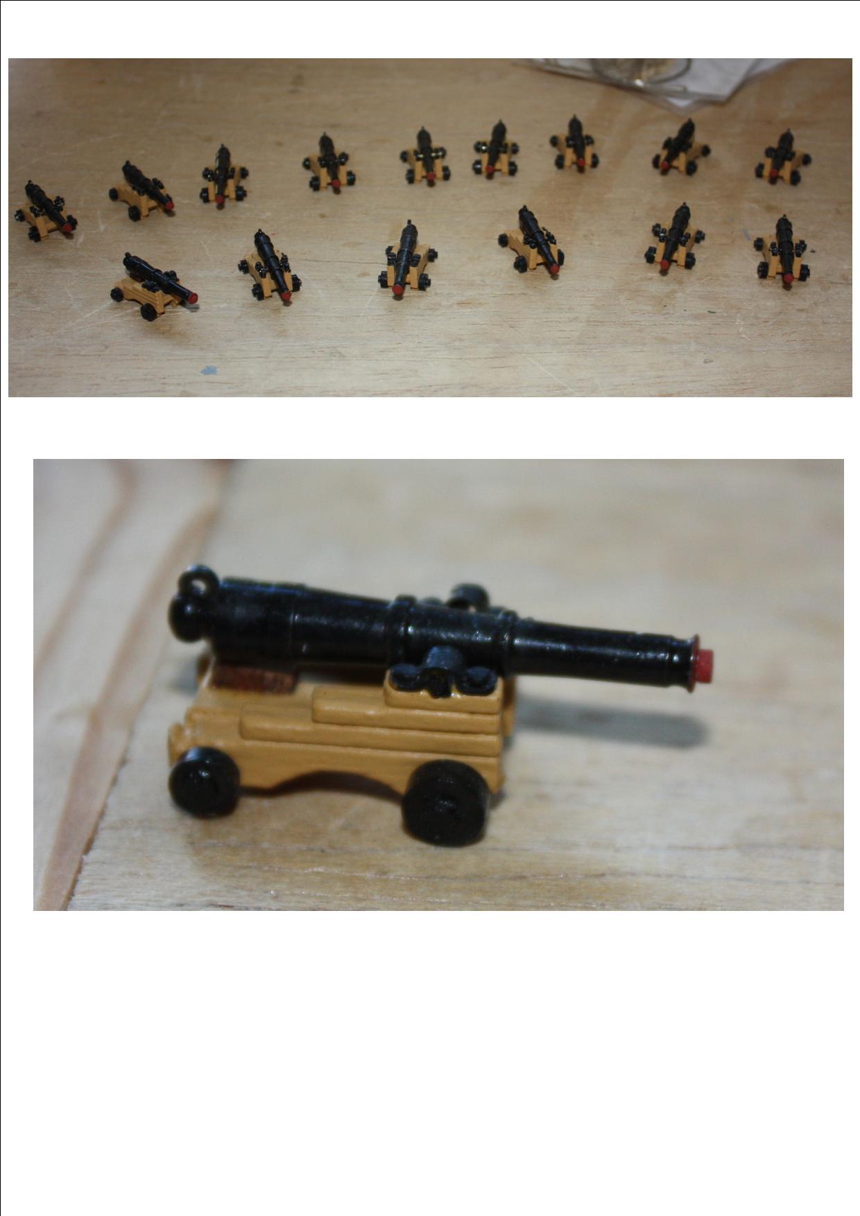

Is the only difference between the 12 and 24 pounders the size of the bore????
I have been making barrell plugs (Painted red) for the exisiting deck guns and intend to do the same for the dummy barrels.
Will this cover up the difference I wonder

In my humble opinion as a newcomer to wooden ship modelling, the idea you have in fitting barrel plugs to the twelve pounders on the middle gun deck might work if they were made larger than the diameter of the barrel itself (as your photo shows).
If you wanted to make your build as authentic as possible though, the barrel plugs on the ship itself are as far as I know, only just a little bit larger than the bore of the cannon and wouldn't overlap the outside diameter of the barrel.
A good illustration is found in the book "HMS Victory - First Rate 1765" by Jonathan Eastland & Iain Ballantyne, page 46, top photo.This is a very good reference book which has absolutely hundreds of colour photos of both the interior and the outside of the 'old gal'.
As I say, I'm no expert at this and other shipmates might be able to enlarge on this subject. But anyway, I hope this helps you a little.
