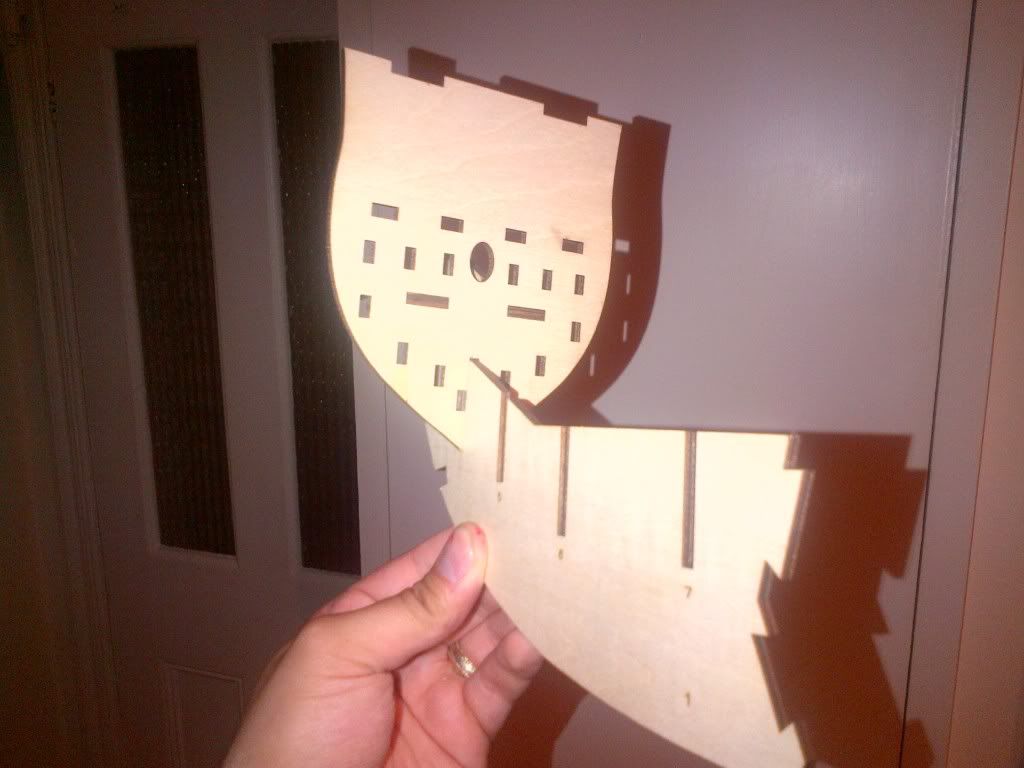

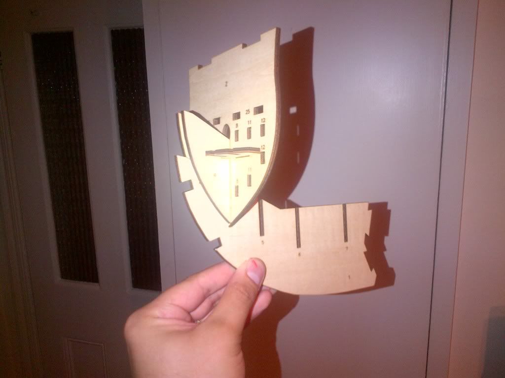

Hi all - glad to have joined and signed to all this. I have a burning issue to resolve. Basically I'm already struggling with the first issue build (a record perhaps?) I'm a total newbie etc. My first question (sorry if this has already been answered on here before) how do I add images to my posts? Appreciate any help at all........thanks

In answer to as to why your images are not showing is that I believe you have used the HTML code in the IMG tags in your post rather than the IMG code from photo bucket.
The HTML code is a query code, rather than a direct URL which the IMG tags need to correctly render the image.
Your build is looking good, and there is nothing wrong with it from what I can see. It looks like the bulkhead is to far forwards on the keel to locate in the slot provided. The flat part of the bulkhead (Part 2) must locate in slot number 2 of the keel. Note as well that apart from a trial fit, at this point in the build sequence this should not be glued. You may also find that this is a very close fit.
I have took the liberty of inserting your images below so other members can comment and help as required.

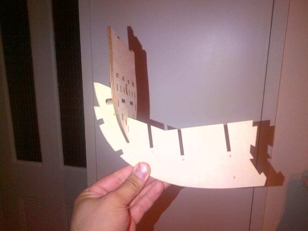

Wow! Very efficient and helpful reply. I guess I'm being over Paranoid. However, when I look at the magazine for issue 1 it looks different when the pieces are together. Basically the magazine shows the fit once in slot 2 coming right down but that doesn't happen for me? The magazine also doesn't show the indented bits once on? I hope I'm making sense with my description...
#5 Posted : 11 September 2012 14:28:14
hi,you need to clean up the slots in bulkhead 2 and slot 2,so that it slides fully down to bottom of keel piece.I use a lolly stick with a piece of sandpaper superglued to it.

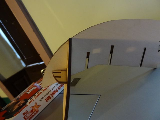

It's a very snug fit and I found both pieces No 3 had to be on the outer edge of the play. I tried a dry fit first and then double checked before the glue set. Still time to rush out and buy a 2nd copy only 1.99.
This is what it should look like

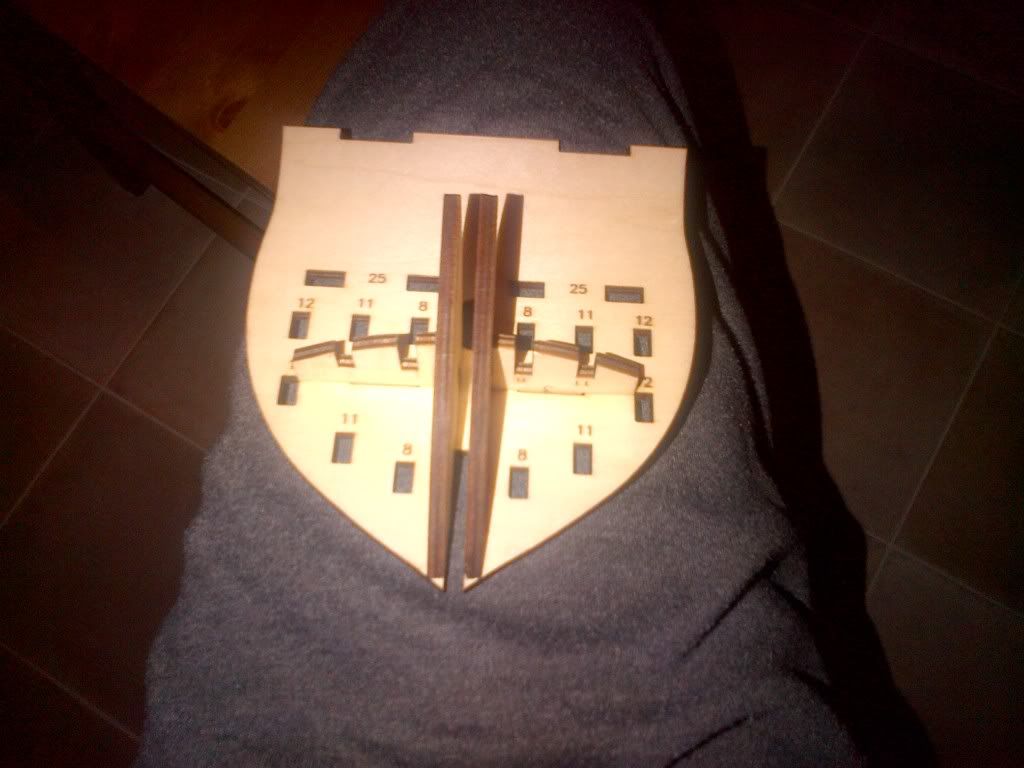

Hi guys - maybe its just me but still doesn't go all the way down - I mean do I have an incorrect piece? The pics above is where I'm at - I have glued it yet. When I slide it into slide 2 it only goes down a short way - the space just isn't there unwell I make slit at the back of the forward bulkhead longer? Sorry once again

Guys I've got it! Bloody hell talk about tight fit? I had to give it a massive push - thought the wood was going to break? Didn't say ram the thing in the magazine? Thanks all!

bronco did you read this?.I use a lolly stick with a piece of sandpaper superglued to it.so that I can widen the slot(s)
yhe reason that the slot seems to close up is ,that it does close up,the glue is waterbased and the wood swells,so you need to widen the slots a little bit.
