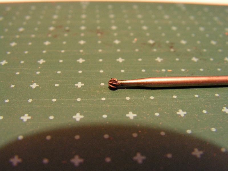

I don't have a 'real' dremel, just one of its many cheaper clones so I'm not sure what the dremel tool you mention looks like. The tool I used to cut out my gun ports is in the photo below. Its just a standard ball shaped cutter but I found it very good for doing the gun ports. The method was to drill a hole a little bigger than the cutter in one corner just in from the penciled shape of the port and then carve out the entire square starting and finishing at the starting hole.
I found it best to have a solid surface to rest my wrists on, either a block of wood or a pile of heavy books and to use both hands to hold and guide the cutter. One handed, it can be a bit too rough as you said and could jump out of the intended path but with both hands its fairly easy to guide it around. Aim to cut up to about 1mm in from the drawn lines and work out to them by file, any closer is a bit risky! Crying
Hope this helps!

Thanks for that. Ah!, I actually have that piece. I thought it more for carving wood than cutting. I was thinking of this bit http://www.dremel.com/en.../ToolDetail.aspx?pid=561

Rob, you're right about that round bit being for carving, that's literally how I cut out the ports, carving a groove into the wood all the way around and then repeating the action going a little deeper each time until the end broke through and then 'cutting' out the waste piece in the middle.
Like I said though, you definately need two hands and a steady balancing point!
