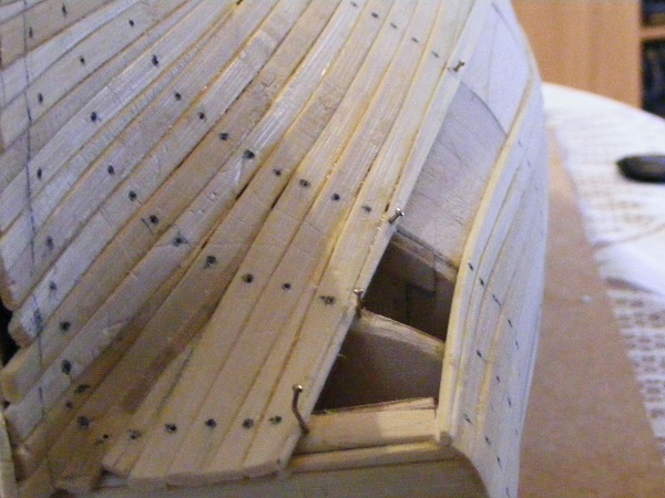

I have been asked several times and have also seen the same questions on other builds about the method of tapering planks especially on the topic of how to determine where the taper starts. I've also seen comments on how difficult bamboo is to cut and work with, yet having used my method throughout my SOTS build so far I have found very little problems. That in mind thought I would put together a few posts outlining the method I use in the hope it will help other newbies who are about to embark on plank tapering...

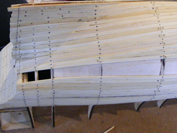

Going to taper the final plank on the SOTS from rib 21 to the stern, this also requires some twisting and bending of the finished plank.
#2 Posted : 03 March 2013 14:18:56

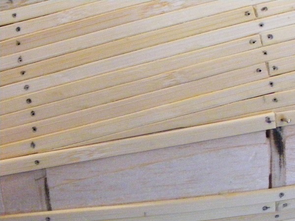

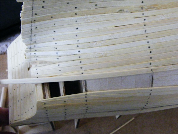

Taking a plank, locate and mark where the pins holes will be on ribs 21 & 22. Pre drill the pin holes in the plank using a .5mm drill or similar and temporarily pin the plank in place. This will act as our anchor point..
#3 Posted : 03 March 2013 14:21:49

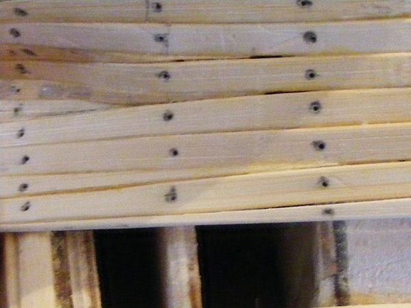

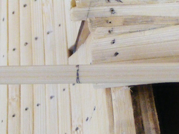

With the plank temporarily in place, mark the start of the taper as shown, this is normalyl where the plank wants to start and ride over the planks already fitted. Also mark the end of the required plank length....
#4 Posted : 03 March 2013 14:28:56

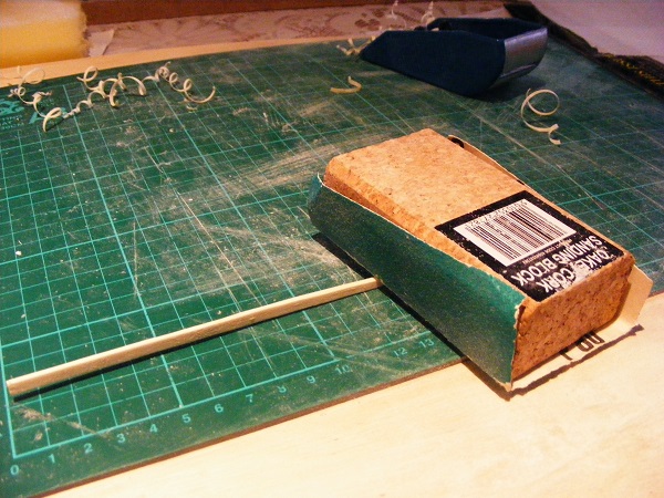

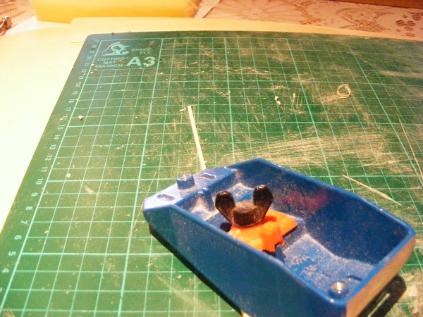

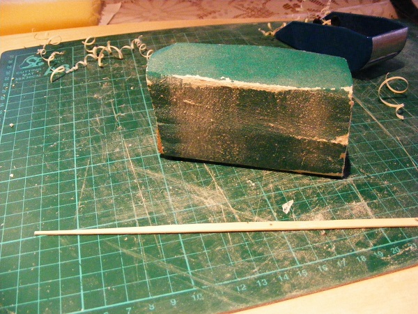

Remove the plank and mark the top edge of where the taper is to start and cut the plank to length. Using a Davids plane, taper from the mark to the end ensuring you keep the taper smooth by using long smooth strokes of the plane. Once the basic taper is in place try a dry test fit to ensure the fit is progressing well.
Using a course grade sandpaper and block smooth out the taper along the length but be careful, course sandpaper will remove material quite quickly. If the dry fit is acceptable then bevel the edge of the plank along the full length to ensure a nice fit, this time using a finer grade sandpaper.

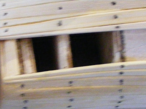

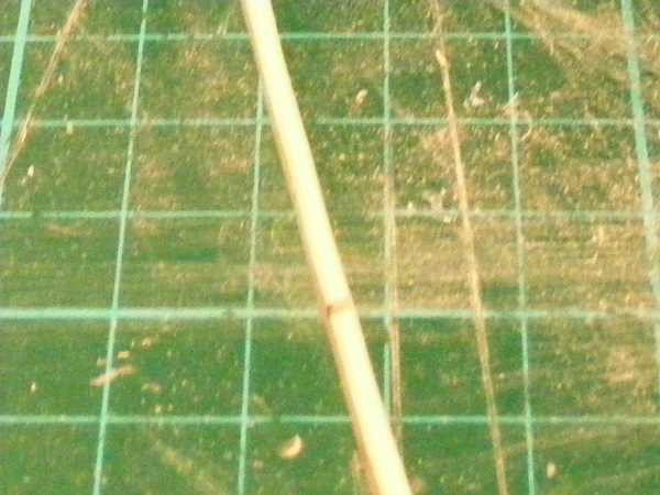

#5 Posted : 03 March 2013 14:33:07
Once a nice fit has been achieved then by using steam from the kettle, bend and twist to follow the profile of the hull... Do a dry fits to ensure all is well.. The dry fit should sit naturally in position without being pushed or forced into position.

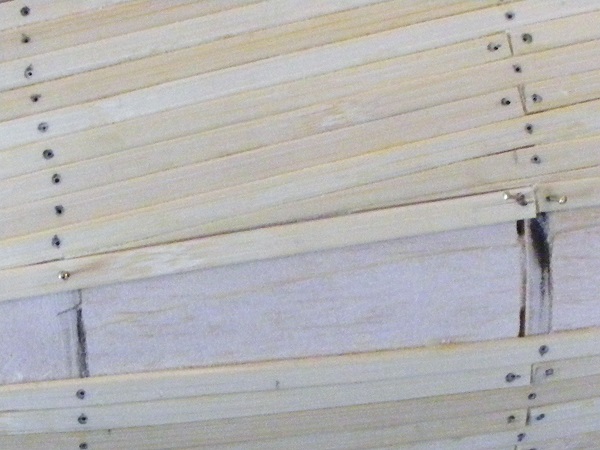

#6 Posted : 03 March 2013 14:35:15

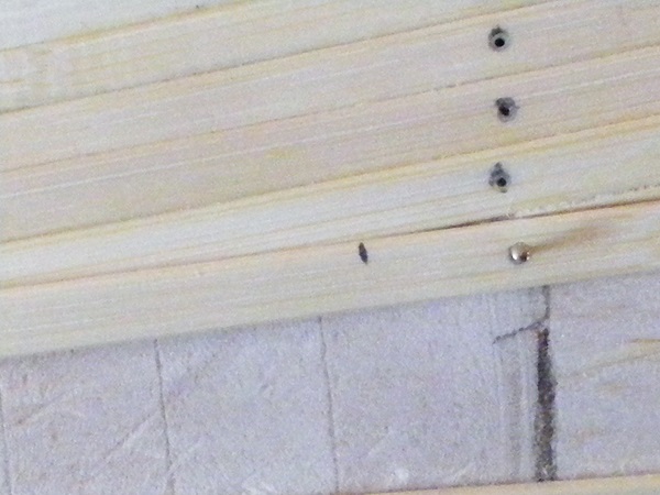

Finally glue and pin in place, removing the pins when PVA is dry...
#7 Posted : 03 March 2013 14:38:02
I fully appreciate there are many other techniques out there to successfully taper planks but I hope by showing other builders, especially newbies to this hobby they will find it useful...

Something I yet have to try out, is making use of the wide blade of the standard hand-planer to cut the taper.
It work like the standard plactic one for modeling, only on a bigger scale.
