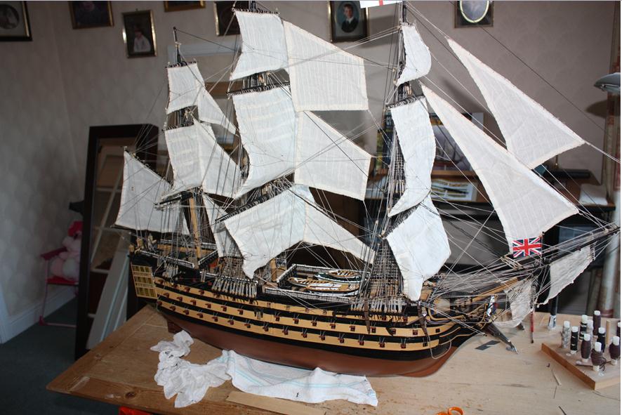

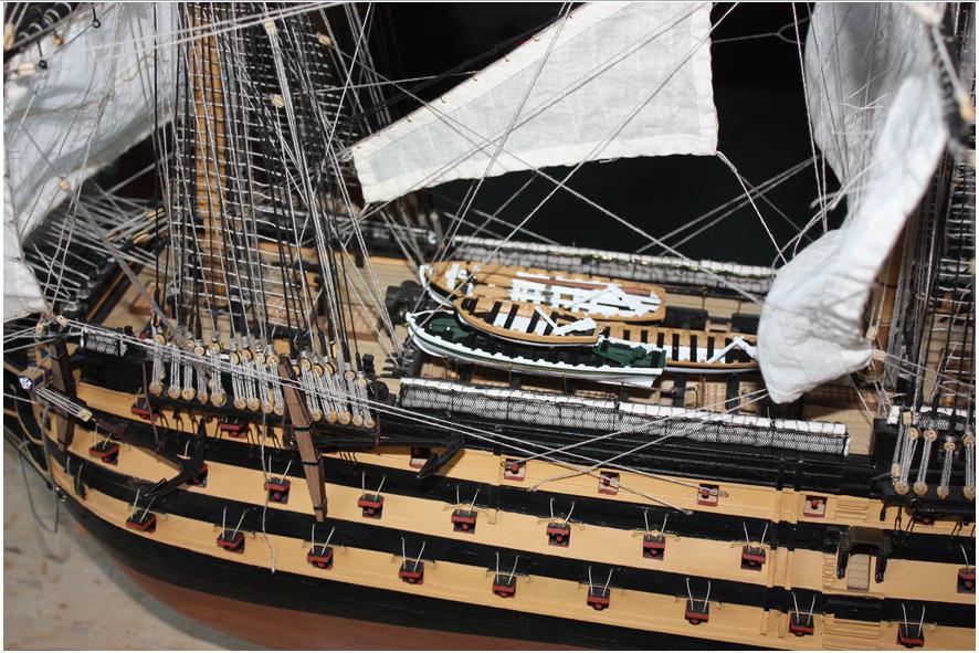

Hi Pam.
Like you I was new to this type of build, but being retired and with "nothing to do" I decided to have a go at the Victory.
I know exactly how you feel, the magazine build instructions are not as clear or comprehensive as they might be so refer to the build diary as this will be a great help. As you have already done ask questions on this forum. Someone will always be willing to answer/guide you as they have me
It is not a quick build so you will need patience and perseverance.
Good Luck with your build
BigGrin BigGrin BigGrin BigGrin BigGrin BigGrin
I have reached the heady heights of issue 120 so am nearly there. Pictures attached
Current Build:-
#20 Posted : 06 October 2013 09:44:32
That build looks absolutely brilliant. You should be rightly proud of producing such a wonderful piece of work.
