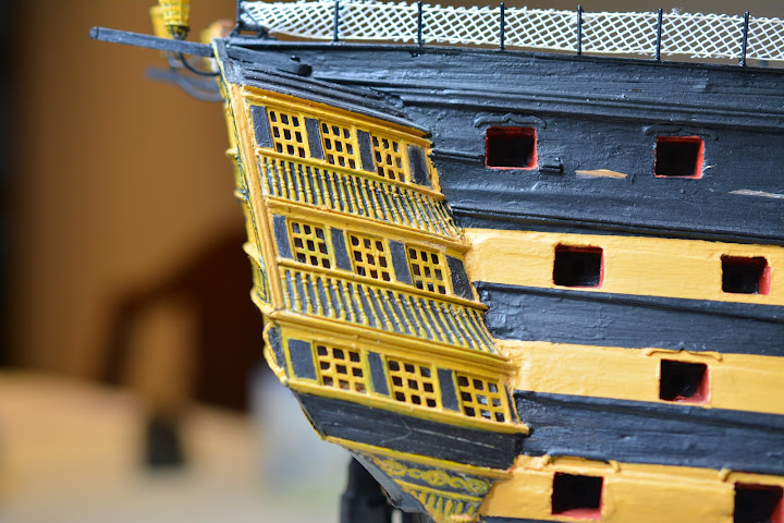

Next up was the stern galleries. Del Prado's one wasn't too bad for shape etc as I recall, but no decoration and a piece of card with windows printed on it to stick inside, not very realistic looking to say the least. I think it caused so much negative feedback that they provided a cast metal replacement later on in the build, but by that time I had already made other arrangements.
Searching the internet looking for 1/100 scale HMS Victory parts didn't help much but did bring to my attention that there was a 1/100 scale HMS Victory kit made by Helller. I was talking to a fellow modeller I was working with at the time and he mentioned that he owned that kit, had purchased it a few years earlier with good intent, but never really getting started with it, and he was willing to sell it to me at quite a reduced price, so I arranged to go and see the kit.
Imagine my delight at seeing a nicely moulded rear gallery at the right scale. Delving into the kit further I was even more delighted to see that the ships lanterns were moulded in two halves from clear plastic, perfect for my lighting plans. Purchase completed, I headed home eager to make a start.
Once I had temporarily assembled the rear gallery parts and offered them up, it was clear that some modifications would be needed to make it fit, but the overall look was really good.
I added some internal floors made from scrap timber.
This was done mainly as a fixing platform for the yellow LED lamps that would illuminate the galleries.
The next couple of pics were taken more recently with my new DSLR camera.
Notice in the first photo looking at the stern how the ships name has faded. I made my own decal for the name when I did the galleries several years ago, this is how it did look.
I don't know why its happened, but I will have to redo it at some point, perhaps I should have coated it with clear varnish, any tips would be welcome.
The next shot is of the lanterns.
As stated earlier, they were formed in two halves and during assembly, a small yellow LED lamp was installed inside each one. Luckily, Victory's lanterns have a three arm bracket,
this close up of the underside of the centre, larger lantern shows the bracket, the two outer arms are actually the wires feeding the LED lamps.

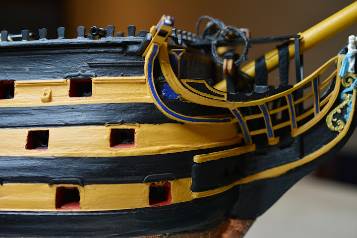

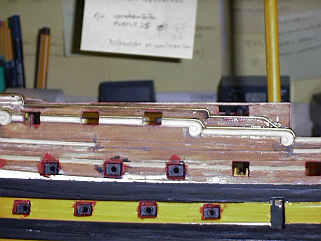

Next I tackled the hull decoration and wales.
The Del Prado build did not provide for any fancy hull decoration and the depiction of the wales was pretty basic, the wales on Victory do not actually follow the lines of the gun ports or the painted bee lines and they rise up at the stern,
the lower wale also has a sort of rebated top edge.
Here is a photo of the actual ship showing the hull decoration at the point where the quarter deck steps lead up to the poop deck.
Through Model Dockyard I purchased a "Victory Mouldings" set from an Italian company called Corel. The mouldings were made from composite wood fibre onto card backing sheets.
The hardest part was getting them off the backing card cleanly.
I used these mouldings and some additional small brass wire bent to shape to create my representation of the hull decorations.
The wales were created by adding additional thicknesses of hull planking to form the approximate size and shape of the three main wales that run the length of the hull. I can't find any pics of the wales before the hull was painted so here are some more recent shots of the starboard side.
The gaps visible in the line of smaller moulding above the upper gun deck gun ports is where the channels will fit.

The Corel mouldings set was used again, along with a bit of scratch building, to enhance the beak head area.
As you can see from the above photo, I had to thin out the timber on the beak to take the figure head, that was made from 2 cast metal figureheads I had bought (using the best bits from each), and the cherubs were from the Heller Victory kit, I liked these because they looked more cherubic (and a bit more like the ones on the actual ship) than the ones on the cast metal figureheads I had.
Painting the figurehead seamed to take forever as I kept re-touching parts that went wrong or I wasn't happy with Blink , but luckily the Latin text around the top of the shield came as a decal on one of the figureheads I had bought.
