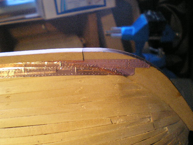

ive just started the copper taping or the hull do I look like im heading in the right direction
cal attached the following image(s):

A word to the wise in case you don't know,keep the lengths of tape at about 6" to stop damage caused by thermal expansion/contraction,it may not be a lot but it can rip the hull to pieces.

im keeping them at 5" was more to make them manageable but thanks BigGrin

What you've got down so far looks fine. It may be just the photo giving exaggerated shadows but you might need to do a little extra sanding and or filling in the bottom right part of the picture. The copper tape needs a really flat and smooth surface to bring it off well, being much thinner than the copper tiles they will show every little bump or depression underneath them!
Also, I gave my hull a couple of coats of satin varnish to give the tape a good surface to adhere to, any dust underneath and I found the tape would peel back after a while.
Best of luck with your taping Cal, it's quite relaxing after a while and a hell of a lot cheaper than tiling it too!

Quite true Robin, the adhesive on the tape needs a smooth, preferably glossy surface to adhere to, and when completed, keep the model away from sources of heat such as a radiator, as this can soften the adhesive and cause the tape bands to move or drop as they expand and contract.
Certainly speeds up the process though..
