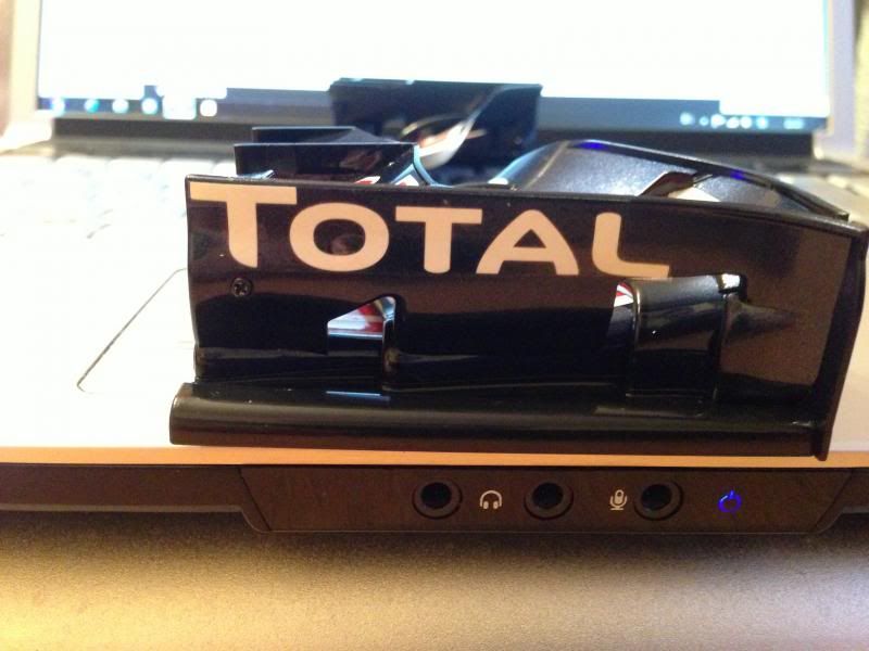

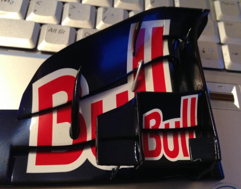

For my RB7 I have used this:
I sprayed after I put all the stickers, and it nothing happened.
The damage on the small "tab" its my fault not a clear varnish.Cursing
