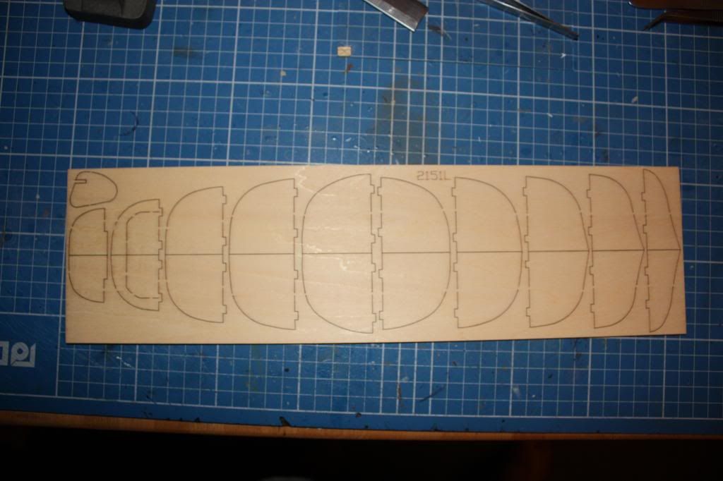

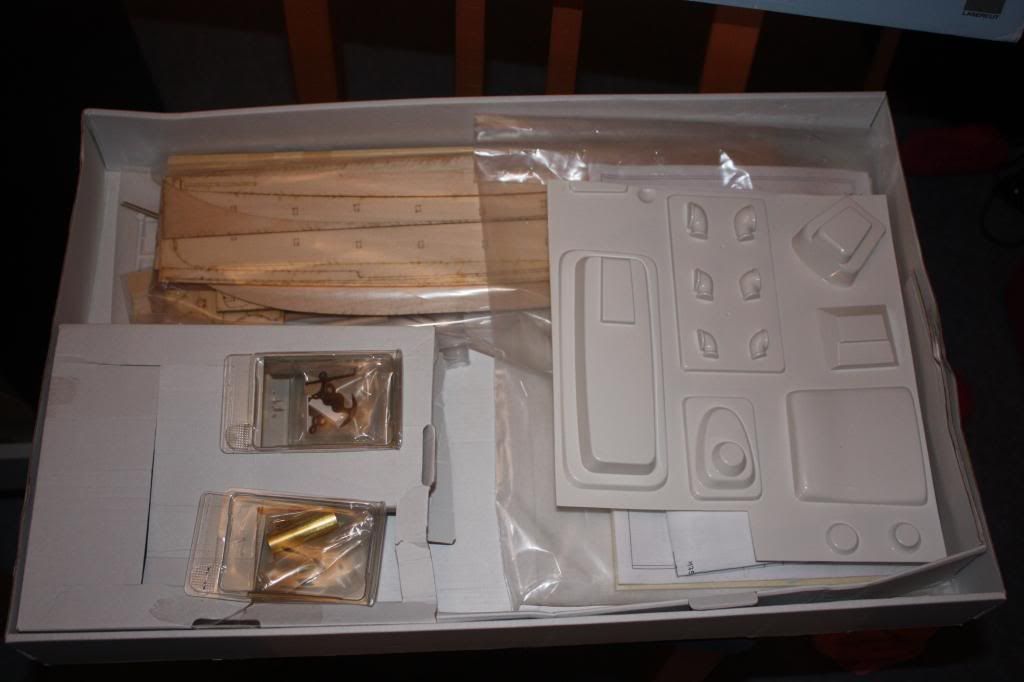

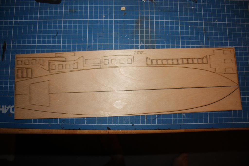

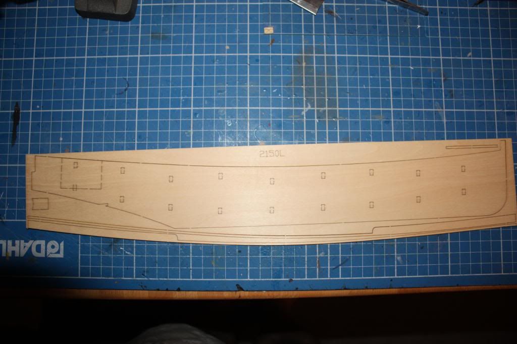

This is actually my birthday present for next month but my Wife alowed me to 'check it' to make sure nothing was missing BigGrin The model is her choice as she wanted something a bit less grey on displayHuh
So what is in the box?

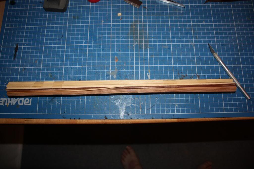

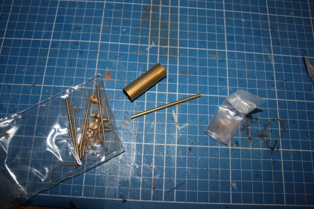

The kit is multi media with wood frame hull, decks and cabin and brass and plastic covering the fittings.
there are some rather simple instructions that leave a lot to the imagination and a late set of plans and a 2005 catalogue!
There is quite a bit of plastic all fairly low quality with a lot of sink and distortion some can be made good bout i will have to try and replace the portholes. There is also some vac formed styrene been a long time since i encounterd this stuff but it is good thick sheet so should be ok although the vents may be a bit tricky. The brass is mainly for railings and Flagstaff's. Interestingly the hull is made in two halves then brought together.
willie

just enquiring dose the instructions tell you to leave a border on the vents etc and rub the border off with sand paper that is placing the vent flat down on a board and rubbing the border off it comes off quite quick and leaves a flat surface for gluing together
#3 Posted : 15 July 2013 21:13:37
Interesting it shows marking it out with pencil then trimming back. would gluing together with a lip and then sanding back work as that was my first thought.

This is a very interesting kit as I did not know that vac formed pieces were part of the build. These have their very own special handling traits - mark around with a pen as you say but I think the process is then to use a sanding board to sand down to the marked line.

Thanks Tony actually not dealt with vac form since I was a teenager so any tips very welcome indeed. I am also going to have to make holes for the scuttles and a bit concerned about it splitting. fortunately plenty of scrap to practice on.

I think for drilling out your scuttles the best tool would be those funny shaped wood drilling bits, the ones with a central spike and two raised blades at the outer circumferance. The spike makes them easy to centre and the cutting blades 'scribe' their way down through the plastic with less chance of splitting.
