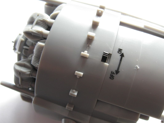

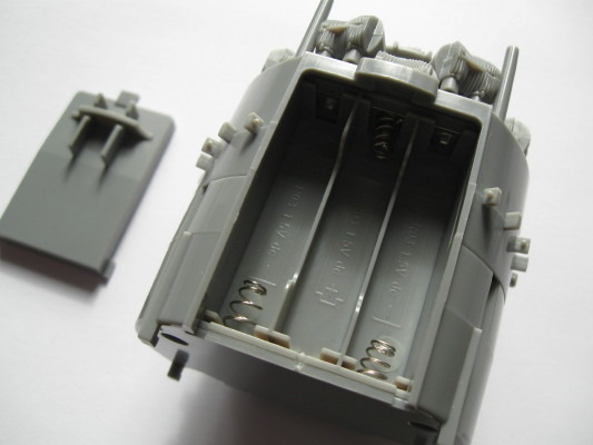

The kit arrives in a standard cardboard box with a plastic insert holding all the components and protecting them from damage,there are a full set of instructions but in Japanese but these will be translated very shortly.
Major components are the main engine body with sound box and genuine Sakae engine sound, propelor, remote,wiring loom, cooling gill parts and finally some decals.
The main engine and propelor come in a grey plastic with a nicely moulded and detailed 14 cylinder Sakae engine with the parts to fit the ignition wires and spark plugs also the cooling gills and muffler shrouds are of an etch type metal, lastly is the green remote control box with batterys.

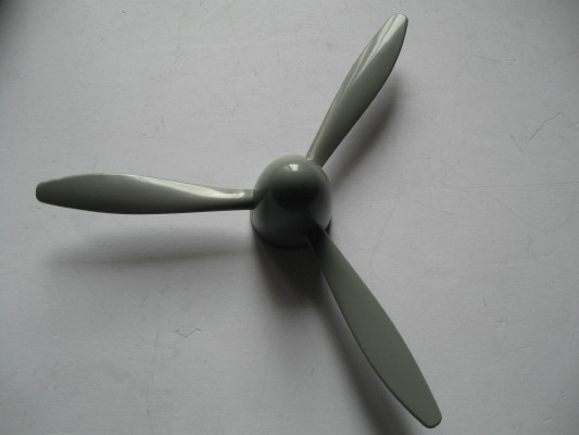

Excellent Review Andy Cool It will be interesting to see if the original metal Prop can be fitted to the Remote engine?

The rear propellor casting on the Zero part work is of solid construction/casting, it possibly could be drilled out but i have the feeling that if its not drilled straight it would cause the prop to spin out of balance and this would soon destroy any bearings in the electric motor. Nice idea though
There is a very simple tool that the R/C aircraft boys use called a 'prop balancer', which costs around £15-£20 last time I looked and does exactly what it says? You could drill a hole in the back of the metal casting as near to centre as you can make it and then just gradually remove a little material opposite any heavy areas until it is perfectly balanced and that would negate any chance of damaging the motor bearings? Just a thought and maybe worth a try .... but don't blame me if you don't get it spot on and end up wrecking your motor!!
The prop balancers can usually be found in the ads in RCM&E magazine or similar or any good R/C model shop?
#7 Posted : 14 September 2013 18:40:54
BigGrin Hi SMM
That is true about the prop balancer i have one myself, but i think the problem will be in reshaping the metal blades and this could involve losing the original shape of the blades due to the amount of metal that may need removing
SennaMentalMe
#8 Posted : 14 September 2013 18:53:45
Very true Andy and I had considered that myself, but I was thinking along the lines of might it not be possible to remove material (using a drill and removing small amounts at a time) from the back of the propeller boss and towards the outermost edges of its' diameter instead and that way you could retain the blades' shape? Mind you, who's to say that the metal blades are perfectly equal in weight and shape to start with anyway since they would have been sanded and polished individually before assembly, which likely means that no two blades would be the same anyway, so it would be difficult to know where to start really wouldn't it, unless you balanced it all up BEFORE drilling any hole and then rebalanced it after? There is also the increased centrifugal force to consider because of the large weight increase of metal over plastic, which might put a lot more strain on the bearings anyway, even if it was perfectly balanced? Most likely why DeAg have used a perfectly moulded blades/boss assembly in the first place because they could foresee such balance problems in the design stage!?
Probably best just to stick with the proper plastic unit but to use the metal parts is not impossible, just very expensive if it goes wrong and don't forget there is only a limited number of these available if you should need a replacement?
