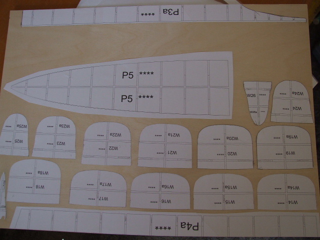

After reading what has been done on this site I decided to try a conversion of a paper/card model into wood/plastic. Looking at what's available, finally decided on a GPM Kit of HMS Naiad for the various reasons
Size - its 780mm long x 80mm beam at a scale of 1:200
Photo etch and turned gun barrels are available from the same supplier
Laser cut handrail is also available
All frames and keel parts are in 2mm card on the original but can only get 1.5mm ply so will have to work from centrelines and adjust accordingly
For planking going to use wooden stirring sticks that can be bought cheeply from the internet (If it is not successful then not much lost)

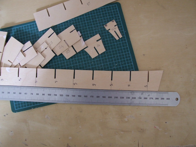

After copying all relevant parts and sticking to ply they were cut out and the frames reduced by the thickness of planking.

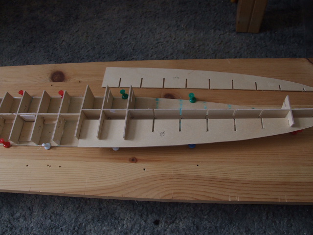

Glued the waterline parts together and pinned to a base board. stuck keel section down and added fillets for support. Will add lower keel when upper section complete.

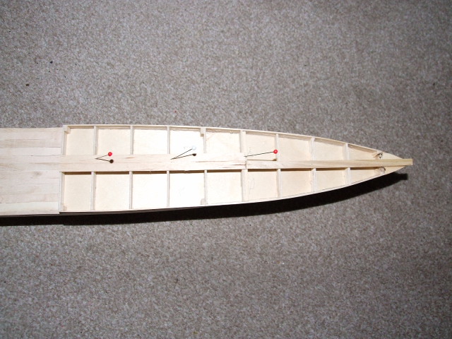

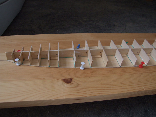

Hull progressing nicely. Glued frames to waterline section

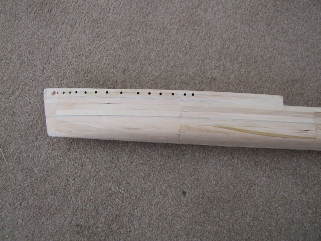

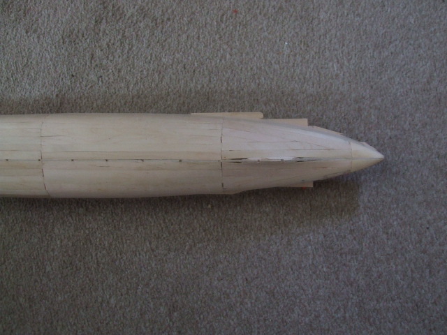

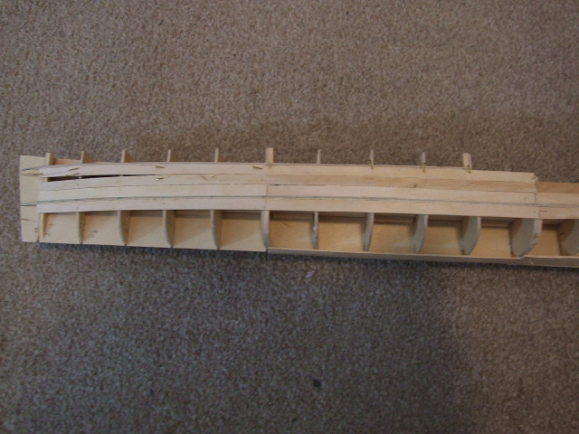

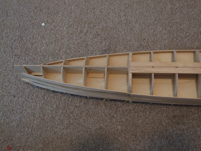

Started planking the hull. As the timber I'm using is only 150mm long I've added extra wood to the frames where required. For the bow and stern areas I will be adding blocks and shaping to suit

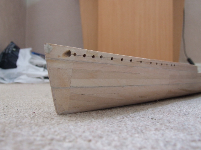

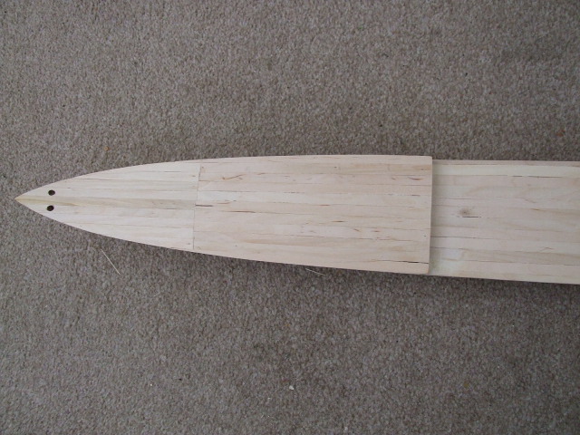

Decks planked and hull sanded. Used paper templates to mark portholes and hawse pipes. Drilled oversize ready for next layer.

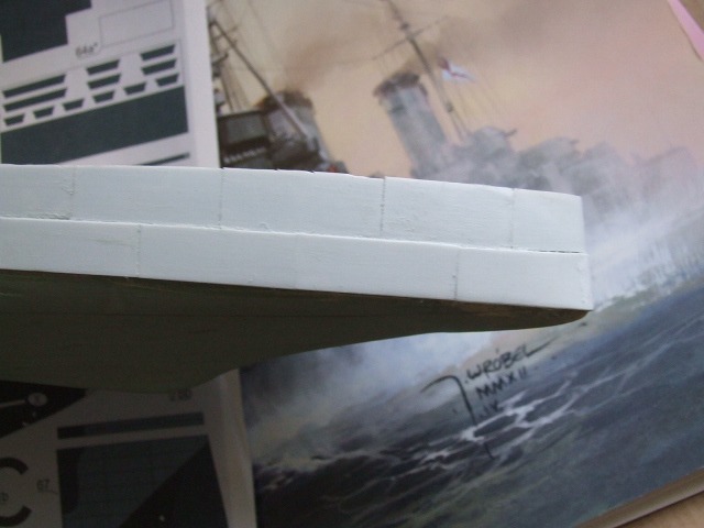

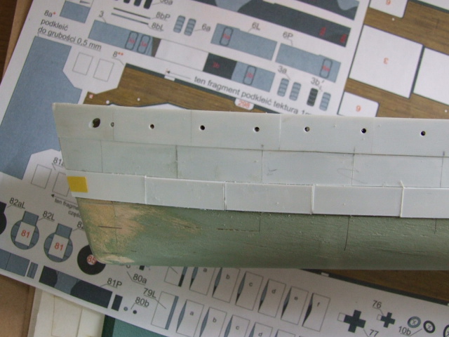

Started plating the hull. The plates are 10mm deep. This seems to look right compared to photographs. The plastic is stuck down with RC Modellers glue in alternating bands of 0.5mm and 0.25mm plastic.
