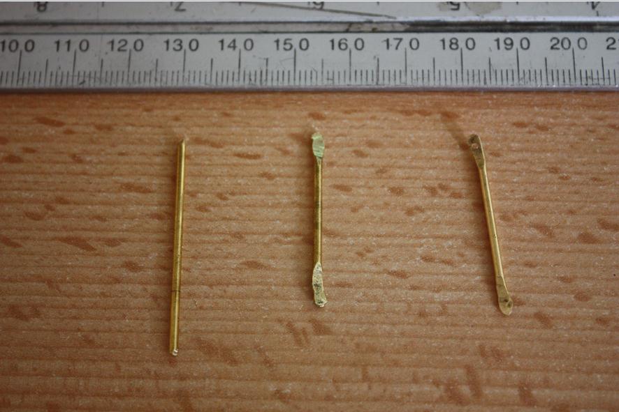

Well you could always order up a copy of one of the Mags in which the original supports where included but as we all know the delivery times can be protracted
The other option as already stated is to make your own.
try this
Take a length of Round Brass rod ( I had some 1/16" in the garage)
Cut a length using one of the original supports as a guide. I would cut it longer than required. Flatten the ends, I used my lump hammer as an anvil and an ordinary hammer to beat the c*** out of the brass rod.
Once the ends are flat you can shape them using a file or a dremmil if you have one, drill the holes for the pins. Jobs a good one
It took me about 5 mins to produce one
Piccy attached. Note sure about the size as I do not have one to use as a guide
Best of luck

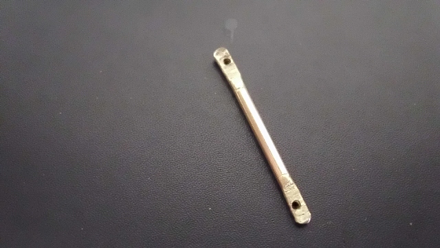

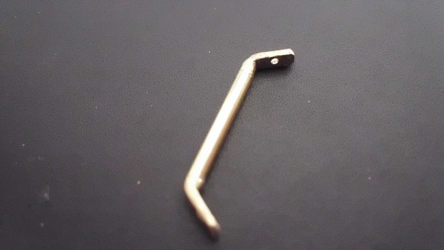

All doneBigGrin I used brass wire / rod and found that with flat large pliers you can crush the ends a bit at a time.
The last pic shows the new piece in place (foreground) the rear one is an original for comparison.
Thanks all for your support.
#18 Posted : 05 November 2013 14:59:58
WTG Steve,Cool
That`s looking good.BigGrin
