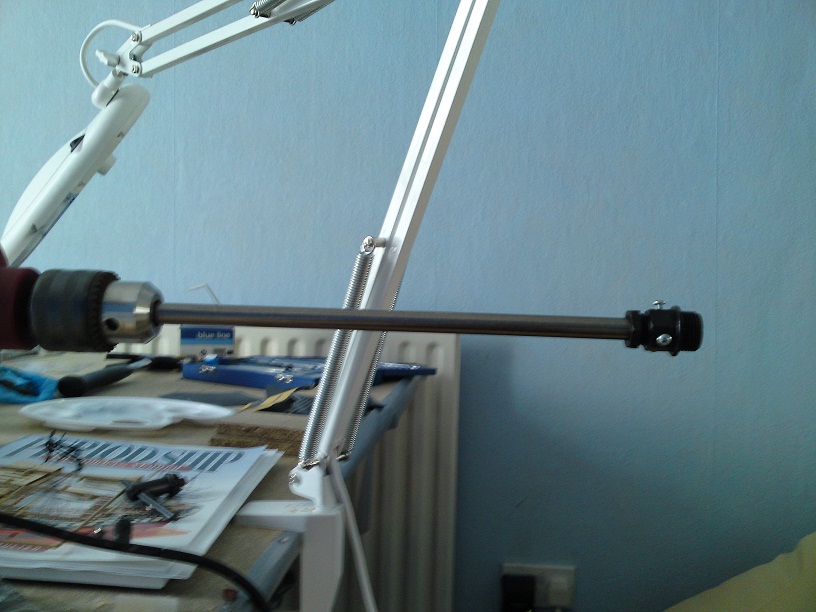

Not sure but dont think a lathe would be suitable, only say this because my understanding is you have to have excess material you can cut off at the ends of the masts and yards. Dont think we will get excess material, i got someone i know to make an attachment for a drill that means i can support a yard from the centre and sand down, turn it around and do the other end. I could be wrong about lathe though.

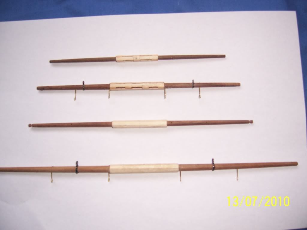

here a tip if you have a 200mm sliding bed, pack the none wheel end out by 2mm tighten boath ends with locks you will taper your mast approx 6mm dia to 4mm over 120mm just by machine alone different beds different tapers same with different packers , the packers i use is just off cuts of wood 2x5 mm

Mike, i use an attachment for the drill which holds the dowel in the centre so you can sand one side then turn it around, so no clamping the side already sanded. Must admit i did not make this but i did draw it and someone i know made it. Its just a hollow tube that will fit into a dremel or drill. The 3 screws holding the dowel do not have to be tight so as long as you put tape around dowel centre they dont leave a mark.

these were done useing the unimate1-classic end supported buy running centre

I'm not knocking the idea Andy. The set up looks impressive.
My efforts with a drill were a bit tentative and I guess that at the back of my mind I wanted to get the wood turning lathe with variable speed and support at both ends of the dowel etc. and to extend my craft interests when I get the time to make other objects. (Time what's that?)

Thank's for the tip and from your pictures looks like a good way to taper the masts, the modular design of the Unimat 1
is Great! isn't it!
