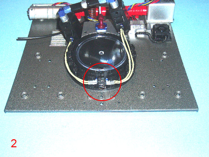

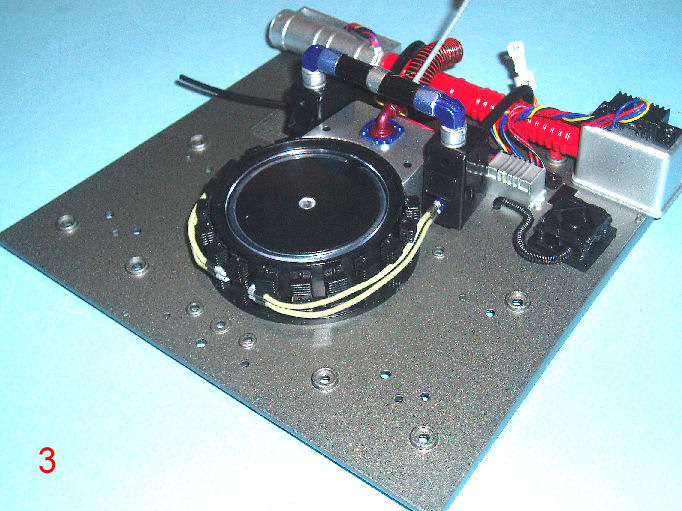

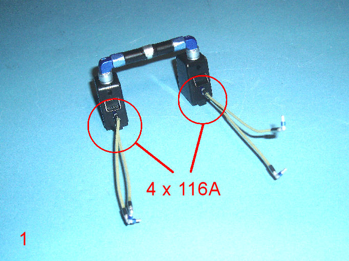

STAGE 116:
Reactor drum cables.
Pic 1: For this stage you will find it far easier if you temporarily remove the assembly from the previous stage.
Do not lose the screws.
Press-fit the straight connectors on the 4 x cables 116A into the locating holes shown.
Pic 2: Press-fit the other ends of the cables into the reactor drum as indicated.
The upper cables go in the top holes, the lower cables in the bottom ones.
Pic 3: Re-fit the assembly to the base plate.
Store safely for now.
