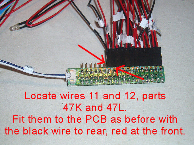

STAGE 47:
These parts are for adding further wiring to the PCB units.
Retrieve the PCB, part 45G.
Locate the wires 47I and 47K.
As with the previous wires on the PCB, fit these in number order next to the previously fitted wires, keeping the black wire at the back and the red wire at the front.

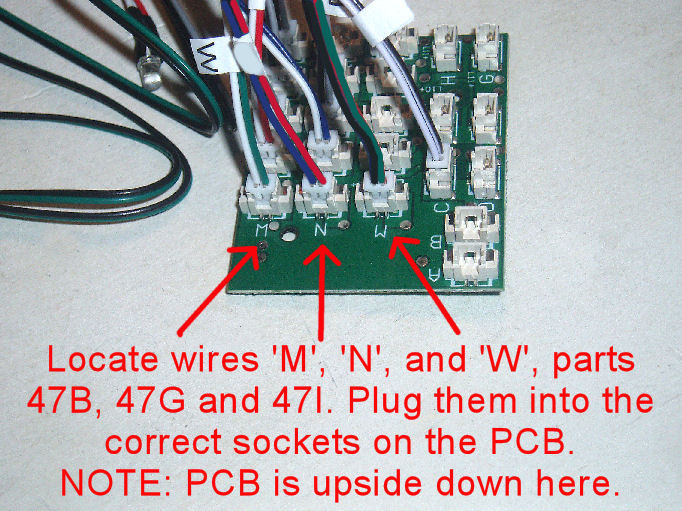

Locate the wires ‘M’, ‘N’ and ‘W’, parts 47G, 47B and 47I.
Plug them into their respective sockets on the PCB.
NOTE: Make sure you are looking at the PCB the ‘right way up’ so you don’t confuse socket ‘M’ with socket ‘W’.

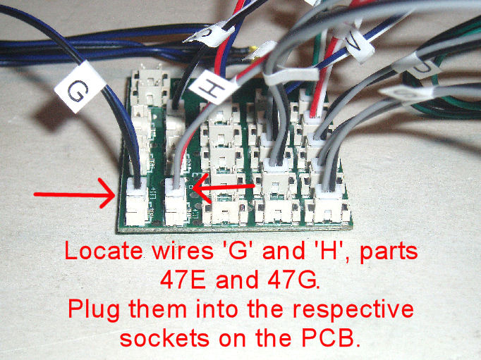

Locate wires ‘G’ and ‘H’.
Plug them into their corresponding sockets on the PCB.

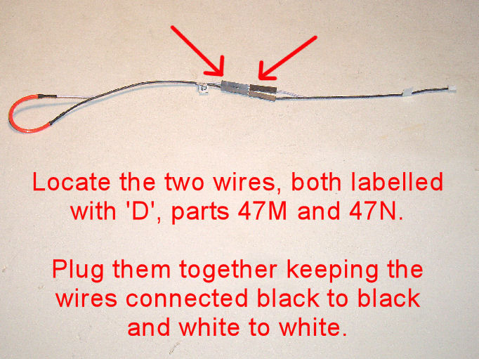

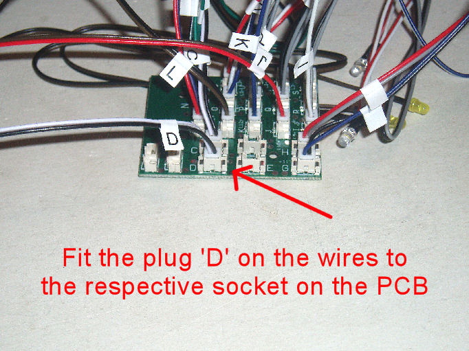

Locate the two wires, both labelled ‘D’, parts 47M and 47N.
Connect their plugs together making sure you connect the black wires together and the white wires together.
Fit the plug on these wires into socket ‘D’ on the PCB.
